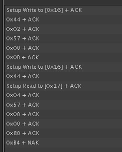

I'm in the middle of implementing bq78350-r1 communication via SMBUS.
So far everything is working, but one thing I can't figure out with CRC:
When I do a normal read for instance SoC, I do receive from bq78350-r1 a CRC, which I can also calculate. For example:
Read SoC (0x0d) leads to following response: 64 00 92
0x92 is the CRC received from bq78350-r1
So if we calculate the CRC with the following data like described in www.ti.com/.../slua475.pdf:
0x16 (slaveID) 0x0d (memAddr) 0x17 (slaveID) 0x64 (data) 0x00 (data) the result is: 0x92
It can be checked also here: www.sunshine2k.de/.../crc_js.html
But If I execute a read command with manufacture Access, e.g. for the Manufacturing Status (0x0057), I receive the following data: 0x2 0x10 0x00 0x84
0x84 is the CRC received from bq78350-r1
The received data is correct, I checked it with bqstudio, so I don't think it is a hardware communication problem here.
No matter how I try to calculate CRC from that, I never get the CRC, which I receive from the chip.
I would guess it's the same logic for crc data packet like:
0x16 (slaveID) 0x44 (memAddrBlockAccess) 0x17 (slaveID) 0x2 0x10 0x00
But that matches not the received CRC. Can you please help me which bytes are taken into account in CRC calculation on a ManufactureAccess Read?
Thanks in advance
Paul
