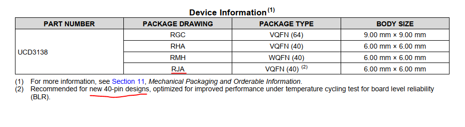

Dear UCD expert,
I see that RJA package is recommended from datasheet,  and RJA package has 4 cornor pins which connect to GND.
From my memory(but it's not very clear), this package has risks of fracture because of the machanical stress is higher than RHA, isn't it?
If my design is 1/4 brick modual, and 12 or above pcb layers, is it neccessary to solder those 4 cornor pins onto board? Thanks...
