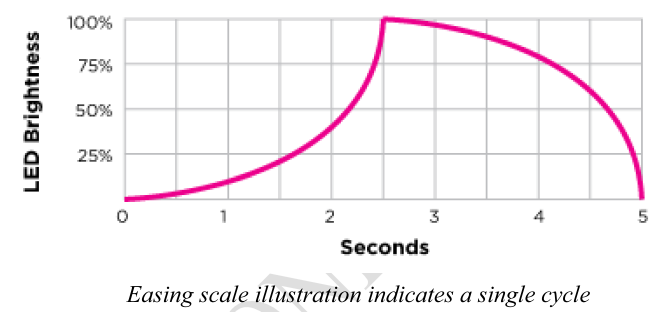

    I need to implement breathing(easing) LED as the requirement below, also breathing between specific blue and red.
    Could you share sample code for breathing between specific blud and red and breathing time comply with the spec below?

  • Hi Kenny,
    I am afraid it also cannot be achieved by only one engine. One engine can control one group of LEDs doing the same behavior.
