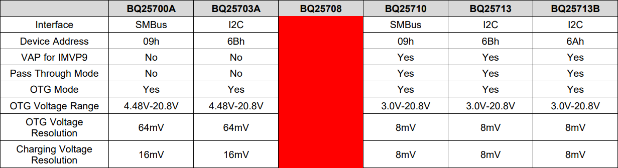

Do any of the following Lithium-Ion/Polymer battery chargers have a configurable float voltage for after the constant current and constant voltage stages?
BQ25700A
BQ25703A
BQ25710
BQ25713
BQ25713B
Are these the only differences between them? Are there any real differences between BQ25713 and BQ25713B other than their I2C address?
Kind regards,
  • Hi There,
         Thanks for asking. Unfortunately none of them support floating configurable voltage. After CC/CV all the chargers listed need host to terminate charging.
        BQ2571X is the second generation of BQ2570X. They are designed for similar application, but BQ2571X series holds some improvement shown in the table.
        From communication point of view, BQ25700A and BQ25710 are using SMbus, but others are using I2C.
        You are right BQ25713 and BQ25713B only hold different I2C address for dual charger application.
