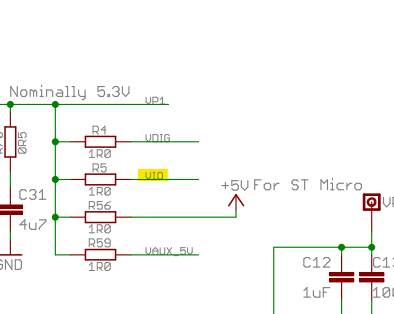

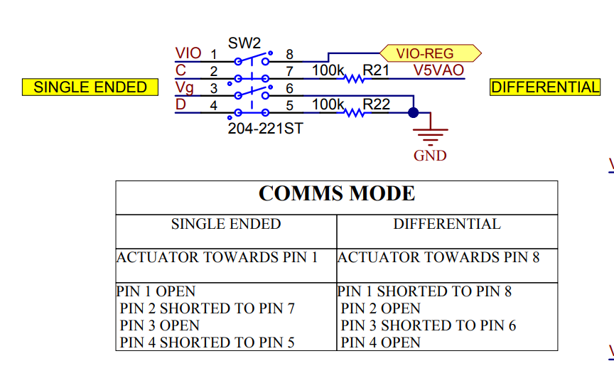

I have installed the GUI to drive an evaluation board of the BQ76PL455 (our own, but very, very similar to the EVM).
