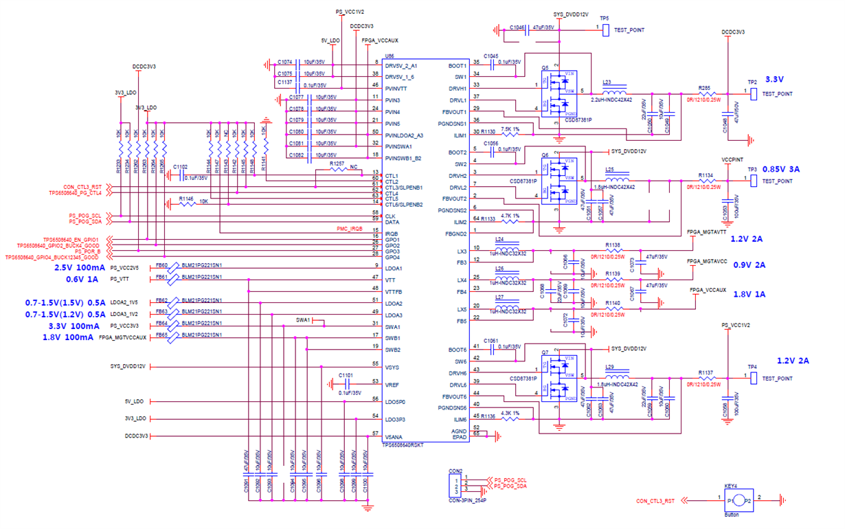

  • Hi Kevin
    Attached is the schematic about TPS650864, please have a check.
    I will continue the debug and the latest result will be updated ASAP.
    Chunjie

    When checking the schematic, it is found that SWB1 and SWB2 are connected together, shown as the last post, is it OKay?
    Chunjie

    From schematic, having SWB1 and SWB2 shorted together would lead to some power loss (the voltage on SWB1 output will discharge some current through the SWB2 discharge resistor), but I would not expect any other issue.
    What is controlling the TPS6508640_PG_CTL4? Just want to confirm that it is going high after GPO1. Otherwise BUCK2 and BUCK1 will turn on at the same time.

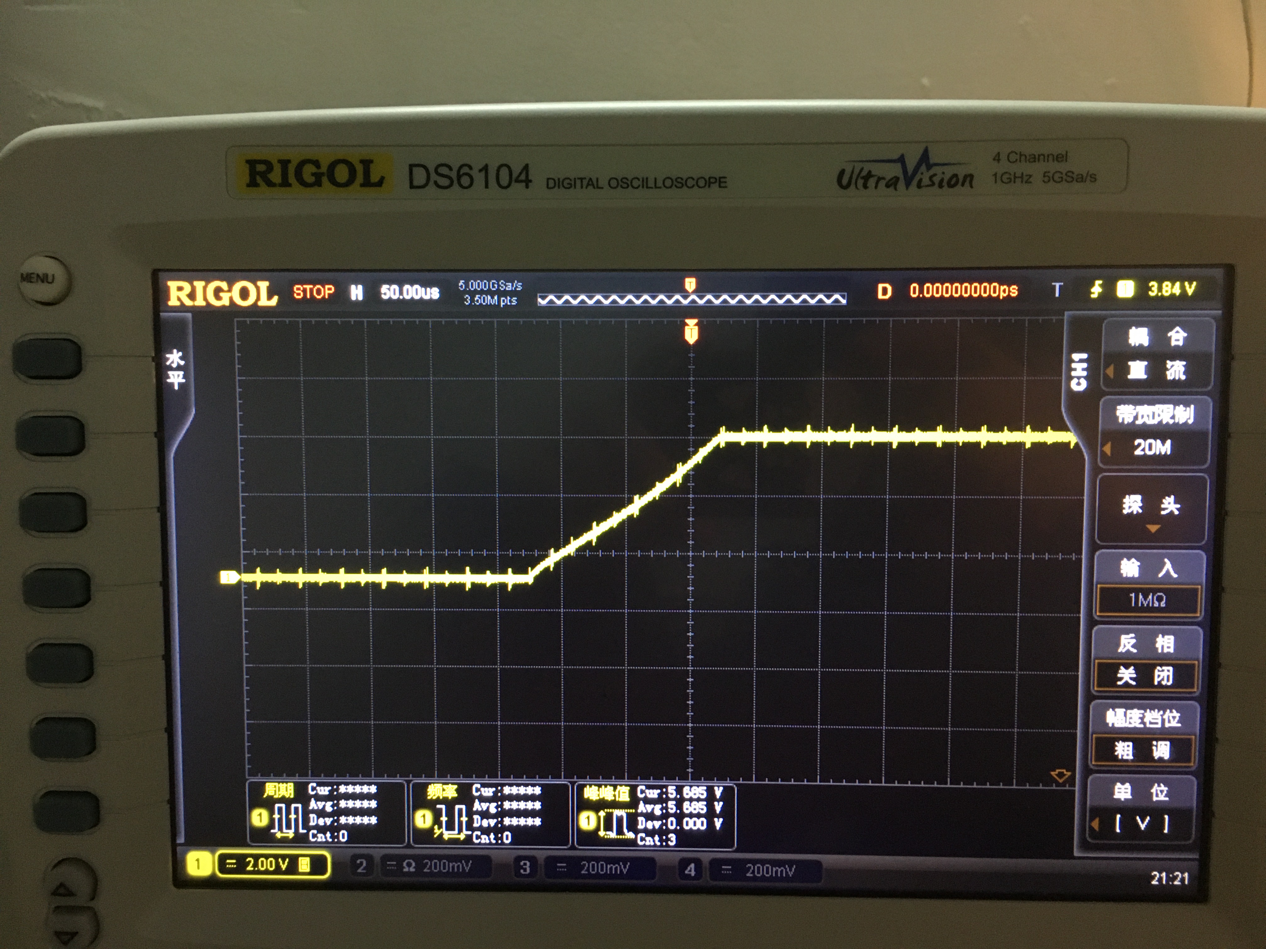

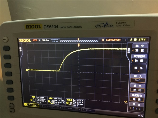

    As you said, there is no improvement when replacing 2x10uF with 2x2.2uF.
    I captured LDO5P0 and CTL4 shots during the start-up, of which both seem okay. CTL4 is the PGOOD signal of another DC-DC chip TPS544C25RVFR
    Chunjie
  • Hi Chunjie,
    Are these scope shots with the DRV5V_2_A1 and DRV5V_1_6 connections to LDO5P0 cut? I was hoping to see the case where LDO5P0 measured as 1.8V.
    However, I had another thought today; if measured resistance when off is high, then it suggests that maybe one of the outputs of the BUCK1/2/6 driver could be shorted to GND? When you disconnect those pins, the LDO5P0 boots fine, but I'm assuming the BUCK1/2/6 don't power up as expected?
  • Hi Kevin
    In the last post, the scope shots are made when DRV5V_2_A1 and DRV5V_1_6 are cut off from the LDO5P0.
    For your idea about BUCK1/26 drivers being shorted to GND, it's okay in my test. When DRV5V_2_A1 and DRV5V_1_6 are disconnected from LDO5P0, BUCK1/2/6 is not working as expected.
    The attached scope shot shows that when both of DRV5V_2_A1 and DRV5V_1_6 are shortened to LDO5P0 during start-up.
    I also did another trivial that cut off the connection between DRV5V_2_A1 and DRV5V_1_6, so that either could be shortened to the LDO5PO. Under such a circumstance, the LDO5P0 is 2.1V.
    At this point, could we guess the current is not enough so that LDO5P0 is dropped down?  Just a guess since the trace from DRV5V_2_A1/DRV5V_1_6 to LDO5P0 point on PCB is above 8 mils, which I think should be okay.
    Chunjie
