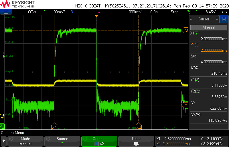

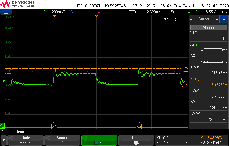

Below the measurement at 2.4V input:
If the input voltage is decreasing, the output drop is increasing.
I would like to have a maximum output drop below 300mV, if possible.
My system is required to be working down to 2.0V input.
