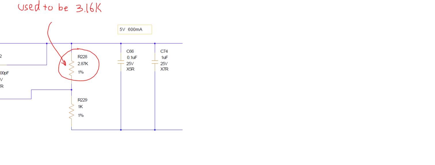

LM5017: 3.16k as FB2 resistor results in 5.4V Vout
Part Number: LM5017
Hi Daniel,
 I am changing R228 from 3.16k to 2.87k (see the attached schematic page). Using 3.16K the output I measure across the board is 5.4V. Although on paper calculation using 3.16K results in Vout=5V, but on the board I measure 5.4V, so I worry stressing the logic too much.
Switching R228=2.87 on paper results in Vout= < 5V, but I measure 5V across the board, which is what I need.
Is changing from 3.16K to 2.87K ok in our design attached, I am keeping all the other components the same.
