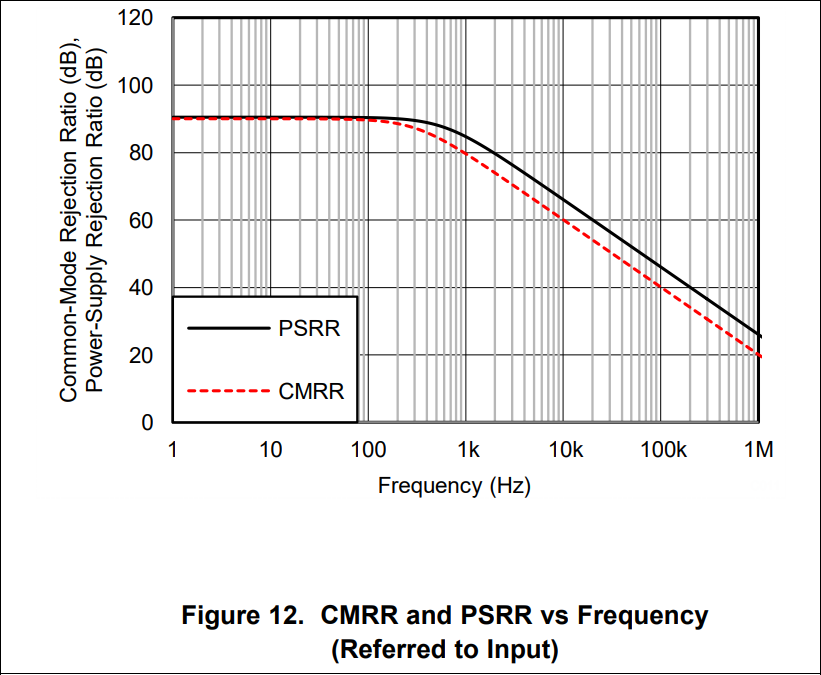

I've chosen the TPS62243 and paragraph 8.3.2 says that in order to minimize the output noise then you have to select the PWM mode correct? But, how much is the output noise in terms of uVrms or mVrms?
I am going to supply the OPA316 Op-amp. Op-amp are sensitive to noise? Do you think that they can both combined together without any malfunction?

    Hello Nick and Alfonso,
    The OPA316 is a nice selection for a low noise op amp in the 10MHz bandwidth range.  Am I correct in understanding that you will take the output of the buck converter and use it to supply the op amp?
    If so, then I should offer you some words of advice.  Any changes to the supply of the amplifier, such as a ripple from the output of the buck converter, will show up as an offset voltage for the op amp.  This offset will then be gained up by any gain in the feedback loop and appear at the output.  To determine the magnitude of this effect, consider the power supply rejection ratio (PSRR) plot for the OPA316, as shown below.
    Notice that, as the frequency of oscillation on the supply pin rises, the effect on the offset of the amplifier will be greater.  At the switching frequency of this buck converter, 2.25MHz, the amplifier will have about 36/37dB of PSRR.  Whether or not this is acceptable is up to you and your system specifications.  However, it may make the output appear too "noisy."  I would also suggest you put some margin into your design.
    We have put together a Texas Instruments Precision Labs presentation on this subject to help customers understand this effect.  Please consider viewing it or looking through the slides.  Feel free to reach out with any further questions.
    Daniel

    Daniel, yes I will take the output of the buck converter to supply (Vcc) a non-inverting op-amp. The non-inverted input will be connected on a 0.4V Voltage Reference and the inverted input will read the value of some sensors. A 12bit ADC will read the output of the op-amp.
    So, ideally, the maximum acceptable output error should not exceed ADC's resolution. I didn't know that buck converter's ripple is seen as offset voltage and amplified...

    Happy to help.  The general rule of thumb is you'll want to keep all your possible error sources going into the ADC at less than 1/2 of the least significant bit.  The ripple will need to be contained to this magnitude and you should also consider any possible errors from op amp and component noise, op amp offset, bias current, etc.

    the tps62243 should work fine with this OPA. The output ripple is less than 10mV and considering the PSRR of the op-amp, roughly you can consider that is attenuated at a value around 100uV. You should consider if this value is suitable for your final application. With the tps62243, you will obtain higher efficiency and if required from your application, you can add after the LDO. You can go in an example from 4.1V to 2.2V and then with an LDO go from 2.2V to 1.8V. Before trying this solution with the switching regulator+ LDO, I invite you to test before our EVM with the OPA316.
