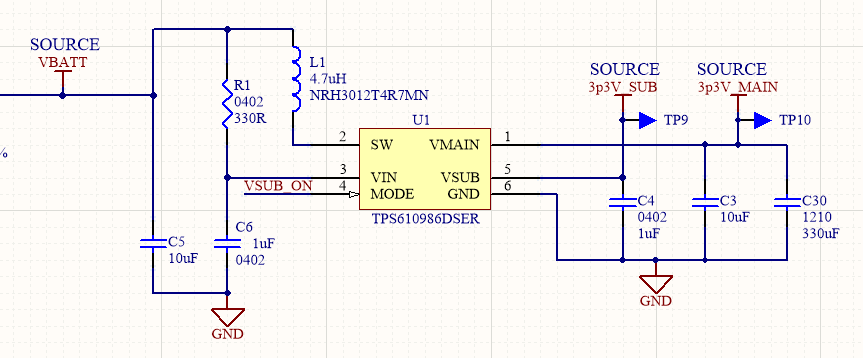

Based on testing my system, I have to add a large output capacitance. While running, the battery contacts can disconnect from the PCB for a few milliseconds, which can cause the boost to drop and the MCU to brownout. I have a 330uF capacitor to reduce the shutdown time so it can withstand the battery bounce.
I have attached the schematic. What should I be testing to ensure that this is a stable system? The boost is powering a BLE chip that can draw 6mA when advertising in low power mode.
I read that if there is large output capacitance, than a 2.2uF cap should be added next to the boost. Should I replace C3 with a 2.2uF cap?
A previous post suggested adding a resistor in series with the large cap.

    To ensure that system is stable measure your VIN and VMAIN during such an event on an scope. With this you can get a good feeling how much the output voltage drops. If you post a screenshot, we can look at that together.
    That additional 2.2uF cap should be close to the device. If C3 is very close you can use that, depends on your layout.

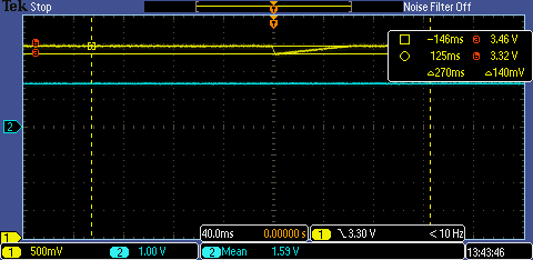

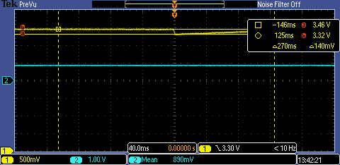

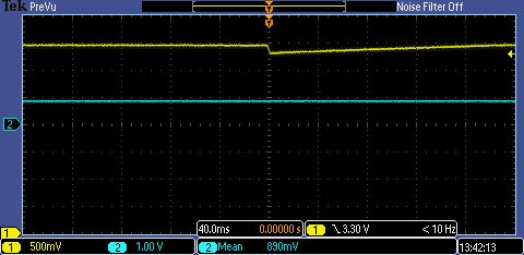

  • Hi Moritz,
    C3 is very close to the boost so we should be good there. Below are the scope captures. I tested with VIN = 0.9V & VIN = 1.6V. The yellow trace is VOUT and the blue trace is VIN.
    1.6V VIN
    1.6V VIN with Cursors
    0.9V VIN
    0.9V VIN with Cursors

  • Hi John,
    appologies for the delay.
    To me the behaviour of the TPS610986 looks ok.
    It'll get reset though. As long as this and the 140mV drop on the output is not a problem for your solution you should be fine.
    How long are those battery disconnects? Always the same length?
    regards,
    Moritz
  • Hi Moritz,
    Thanks for the response. I think I am going to proceed with the larger capacitor.
    I think generally battery disconnects are about 20 - 30ms but I don't have any test data on that. Its pretty hard to recreate in the lab environment.
    John
