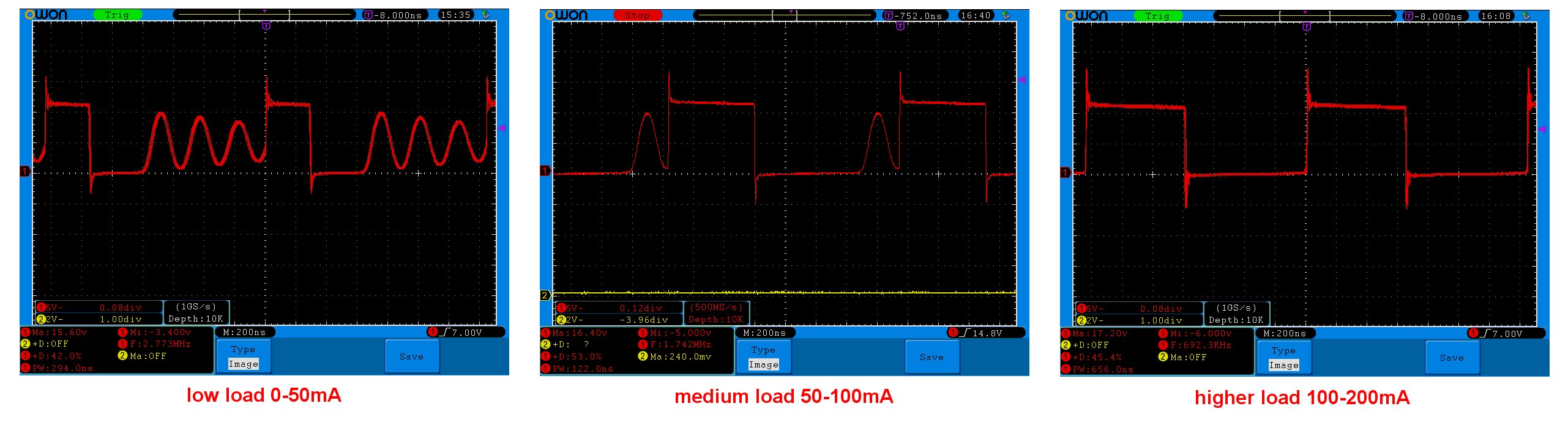

    During EMC qualification testing we have seen some issues with RF Immunity susceptibility in the product between 200-400MHz which is leading us to suspect the LMR16006 5V supply. While checking the design we are seeing some unusual waveform on the SW pin - by unusual, depending on the output current/inpuut voltage it is not pure square wave but instead it is a combination of sine and square as shown below:
    At very low output current the SW node is part sinewave/part squarewave as in (1) above; as the current increases the sine portion reduces (2) above, until at a certain load current (3) above the signal becomes pure squarewave.
    This effect is a combination of input voltage AND output current, ie, if the input voltage is reduced then the same effect happens as increasing the output current ie the sinewave reduces until the signal becomes only squarewave.

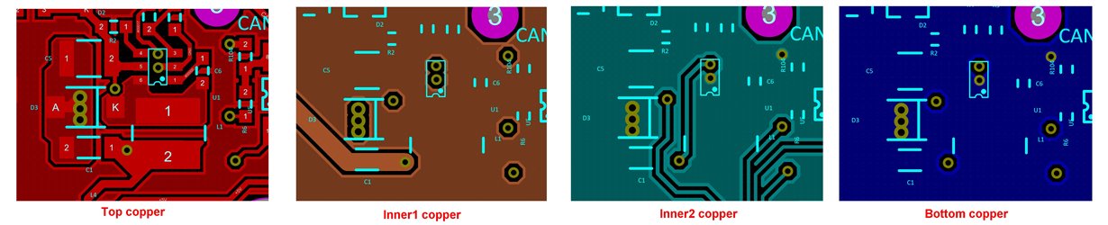

    The schematic and PCB layout is shown below. All capacitors are X7R dielectric with recommended values and the layout guidelines have been followed where possible to keep SW node small (our PCB layout follows very closely the example in the device datasheet):
    Question: is this normal behaviour for this regulator? Perhaps this sinewave portion of the switching node signal is part of the ECO low-current efficiency regime? Our concern is, if this is not normal, this could indicate some instability in the regulator implementation which is contributing to the EMC susceptibility that we are seeing.
    If this is not normal behaviour for the SW node, what could be causing it, particularly in light of the fact that it appears to only happen at lower current/higher input voltage (ie lower effective duty cycle)?

    Question: Is this normal behavior for this regulator?  Yes, this is absolutely expected behavior of the buck converter.  It is just called PFM operation or ECO mode for this part to increase the light load efficiency, the sine wave you are seeing is just DCM resonance ringing between SW capacitance and output inductor. There is a brief mentioning about ECO mode in section 8.4.2 of the datasheet. Hope this helps!
