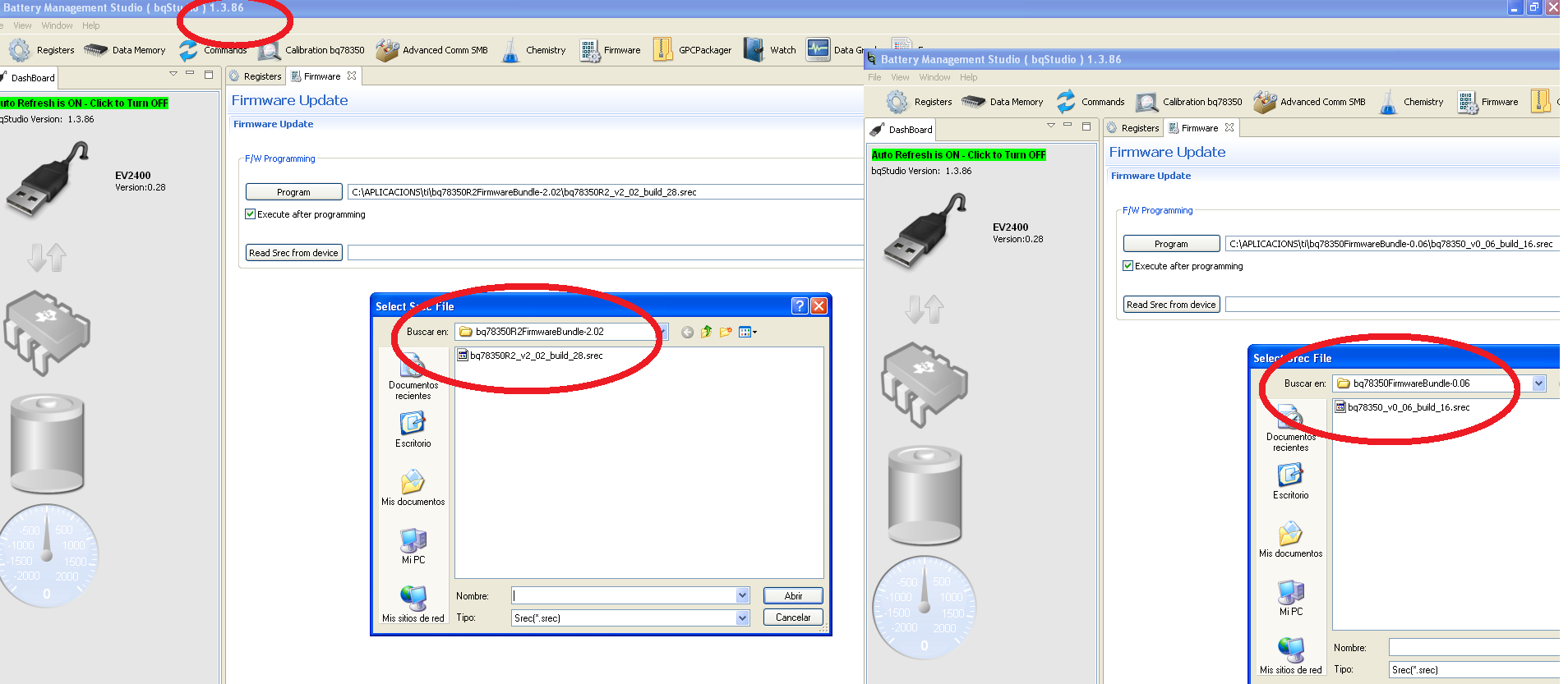

    After the previous steps, I update the bq78350-R1 to V0_06_build_16 with the same results. After I have update to R2_V2_02_build_28 and the communications HAVE BEEN LOST AGAIN!!!! And of course, the device is disable at all. Attach a screenshot.
    I assume that the R1,R2 and all the versions are 100% compatible with the device bq78350, bought WHEREVER. That’s correct?
    So, in my opinion the R2 DOESN’T RUN even the worst, disable the device!!!!
    --->Could you check it? I mean could you update from R1 to R2 with the BQ76930 EVM eval board?
    thanks a lot for your time.
  • Hi Albert,
    I am confused. The BQ76930 is a 10S device, but you are connecting 14 cells? The BQ76940 supports up to 15 cells, so you should be using the BQ76940EVM. Can you verify which EVM you are using?
    There is nothing wrong with the BQ76930-R2 or R1 firmware, so I suggest debugging the EVM first before making any changes to the firmware (especially if your BQ78350 is shutting down since it could shut down while you are writing firmware). The latest versions of BQStudio also work well with this EVM, so there should be no need to switch back to an old version. Once the hardware issue is debugged, I recommend always using the latest firmware and BQStudio version.

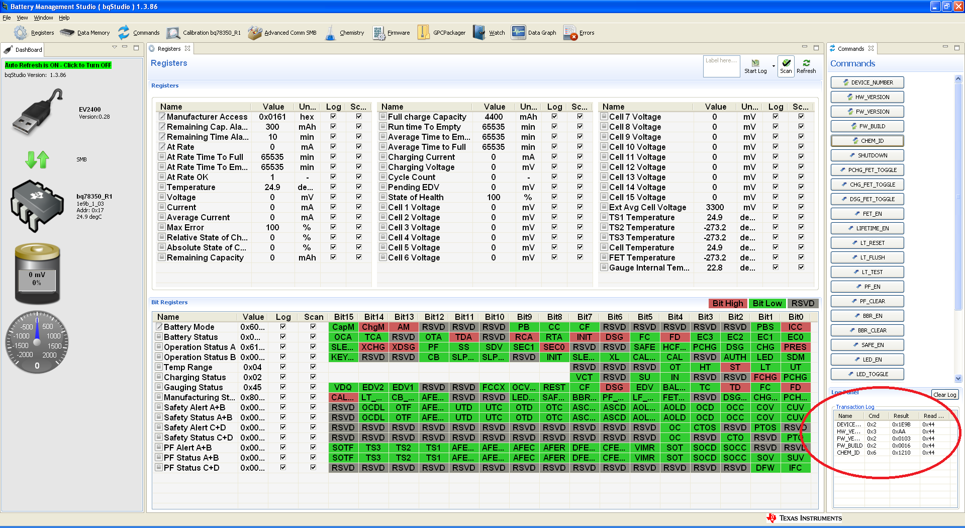

  • Hi Matt,
    My Eval PCB is BQ76940EVM; so 15 cells, nevertheless the #14 is disable externally with a short.
    I have done two test:
    1) With bq76940 Evaluation Software.Connecting the EV2400 I2C por;t to Eval PCB I2C (J8) port. See attach picture. Where you can see the cells voltages set to 3.3V less the #14.
    2) With bqStudio.Connecting the EV2400 SMB por;t to Eval PCB SMB (J17) port. See attach picture. Where you can see the cells voltages are set to 0V. Here as well, you can see some comand request.
    Obviosly the two test runs under the same conditions, in fact just some seconds between them.
    Why bqStudio doesn't give the right cell voltages?
    Seems, that BQ76940 device is measuring the cell voltages properly ; NEVERTHELESS the BQ78350 lost the measuremetns. Any idea?
  • Hi Matt,
    mmmmmmmmmm........ sorry. has been my fail.
    Red means activated; green not activated.
    R1,R2, and bqStudio running as expected.
    sorry again
  • Hi Albert,
    Everything looks correct in your BQStudio screen capture except for the Cell voltages. That seems very strange. The only way I can reproduce this result is to set the AFE Cell Map on the Data Memory screen to 0x0000 and then cycling power on the device. If you AFE Cell Map is set correctly, you should be able to see voltages reported on the cells.
    Matt
