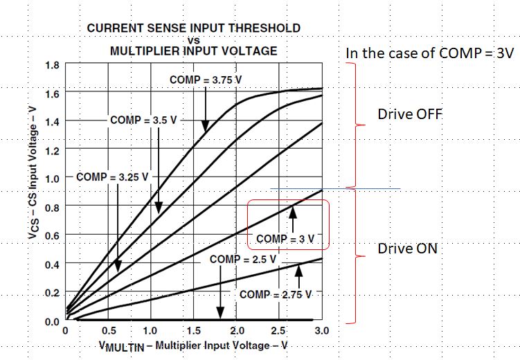

2.  Relation with COMP, MULTIN and Vcs.
     Referring the figure, customer recognize that the threshold of ON/OFF for IGBTs is defined Vcs and MULTIN for each COMP voltage.
     Is it correct the below recognition of customer ?

    1. gM is 90µS typical. The output impedance would be the equivalent impedance of the compensation components connected from the COMP pin to ground.
    2. The CS threshold will change depending on the MULTIN voltage as well as COMP. For example, if COMP = 3V and MULTIN = 2V, the CS threshold will be 0.6V.
