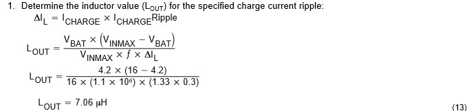

I saw that "Charging NiMH Battery Using bq24105-Q1 in Automotive Applications”
http://www.ti.com/jp/lit/an/slua843/slua843.pdf
Figure 3. shows the value of Lout is 10μH.
Is this a recommended value ?
Can it be calculated using equation (13) in the data sheet below ?
Please tell me VBAT, VINMAX, Freq, and ΔIL when 10μH is decided.

    The datasheet equation assumes that the charger is operating in highest efficiency continuous conduction mode (CCM).  Inductance value is determined by the amount of acceptable inductor current ripple in CCM and also the charger's internal feedback loop compensation.   Inductor current ripple is typically selected as 20-40% of average inductor current, in order to have acceptable output voltage ripple.  Datasheet equation 9 gives the LC product equation for stability.
    What is your maximum input voltage, maximum VBAT and maximum charge current?  We cannot back calculate these values from inductor size.  Freq is the charger's switching frequency =  1.1 MHz.
    Based on other posts, I assume that VINMAX=16V, VBATMAX=3.6V and ICHARGEMAX=50mA?  If so then the Lout equation gives 126uH to operate in CCM instead of DCM but that is impractical.  I suggest using the values in the datasheet L=22uH and Cout=4.7uF or L=33uF and Cout=3.3uF in order to satisfy stability equation 9.  Actually, when charging at high current, the charger must also be able to terminate down to 50mA, it would be acceptable to use Lout=10uF and Cout=10uF but with high inductor ripple current.

    I asked a question to see how 10μH was determined.
    There is no need for back calculation.
    I ask customers about VinMax, VBATMax, and ICHARGEMax value.
    Are there any TI linear chargers that can be used with NiMH for automotive use ?
    I cannot find L = 33uH and Cout = 3.3uF in the data sheet.
    Where is it listed ? Or how was it calculated ?

    Regarding the L and C, I used datasheet equation 9 page 16.
