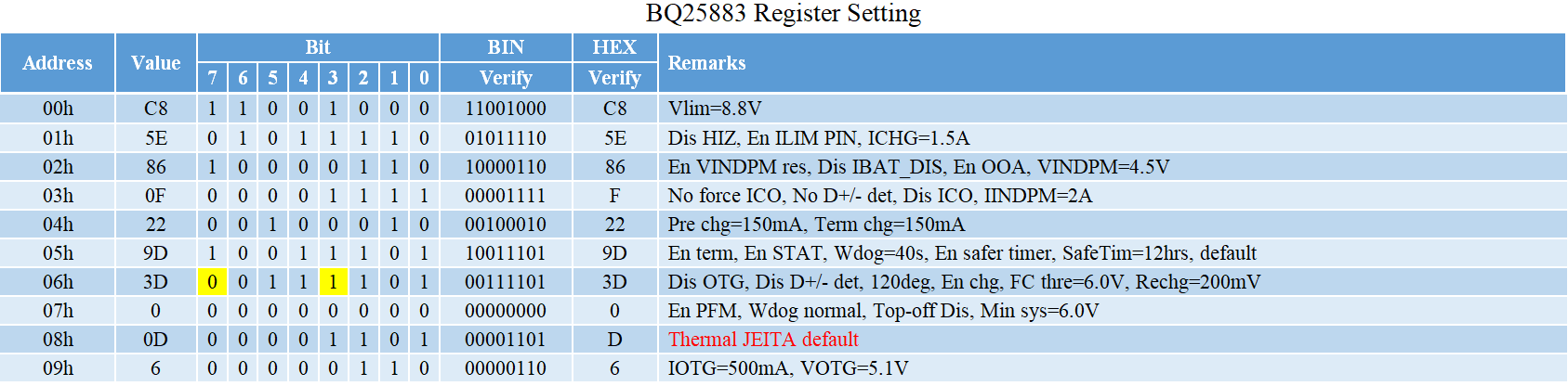

When using BQ25883, Sometimes the whole charging current is 70 ~ 100mA, sometimes it can enter the fast charging state. I cannot loacte the problem. The following is the schematic and register configuration table. Could you please help to check whether something in these two parts are abnormal? Thank you very much.
Note: When using the OTG function, it is necessary to set 06h bit7 (EN_OTG) = 1 and bit3 (EN_CHG) = 0.
