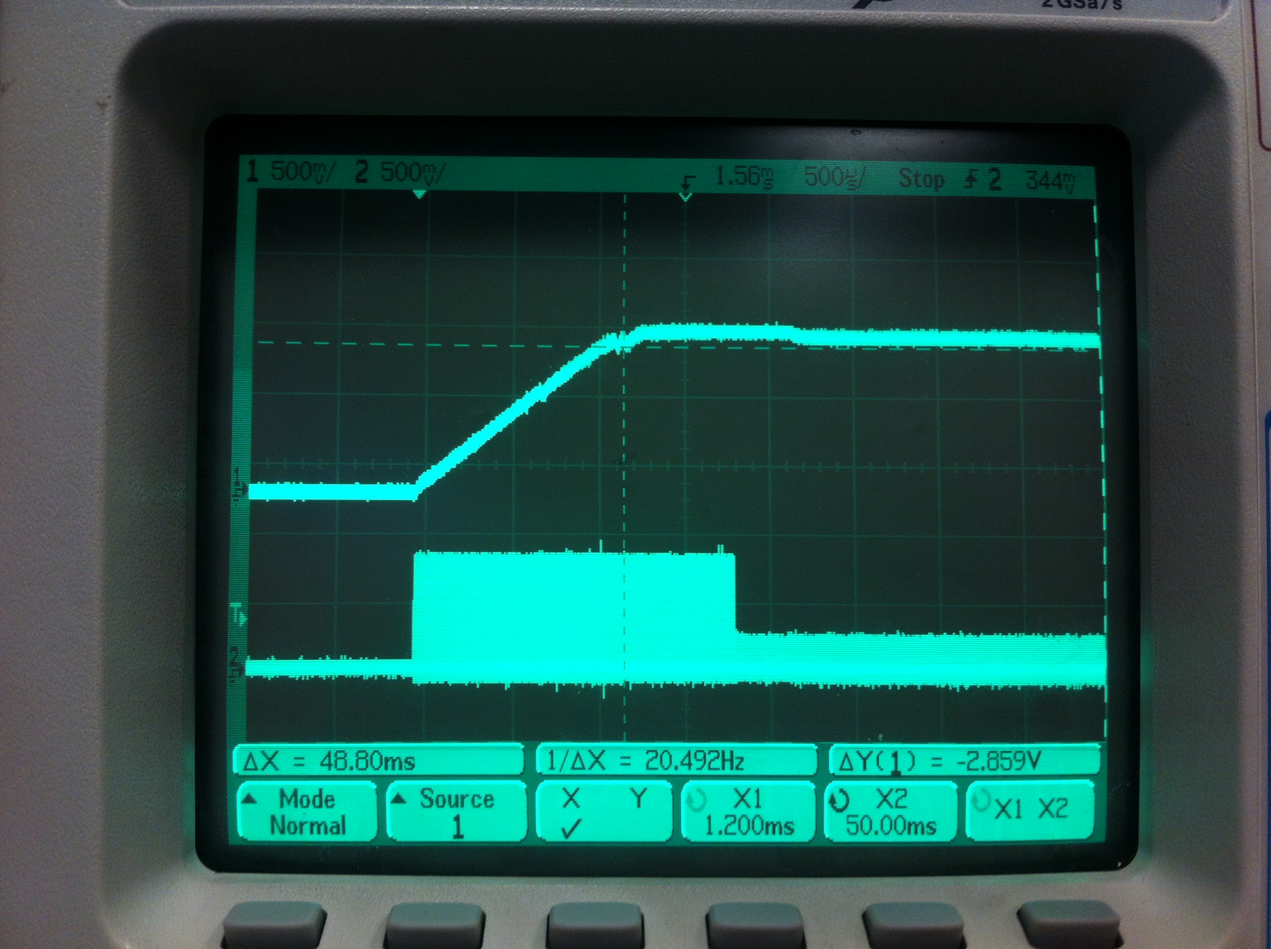

  • Here are 2 plots showing (1) PG & Vout for a bad board and (2) PG & Vout for a good board
  • The noise is exactly a little big, but I still think that should not cause PG be kept pulled low, and I also saw another difference is Vout waveform, abnormal one has some drop and overshoot after getting to the normal operation, could you please share schematic and layout for review?

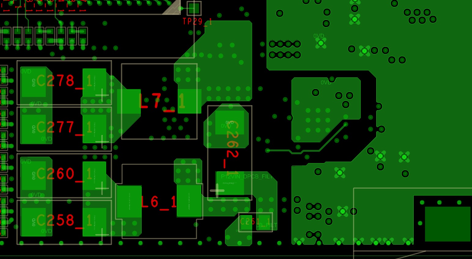

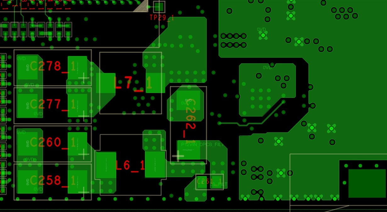

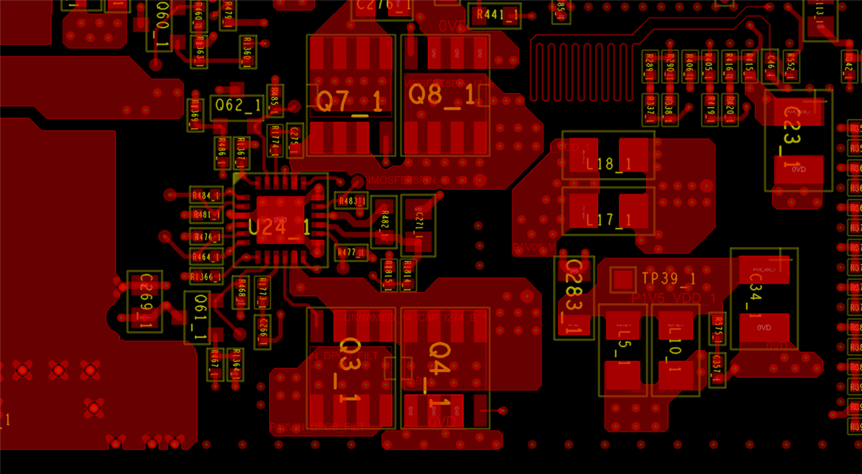

  • Here is the relevant part of the schematic, and top and bottom layout (also included bottom layer flipped for readability).
    The next layers within the pcb (below top, & above bottom) are solid ground.
    8836.schematic.pdf
    Top Layer:
    Bottom Layer:
    Bottom Layer (flipped)
  • No critical points found to cause this issue happen from your pictures, more questions need you confirm

  • 1, For the big noise at PG signal, When testing PG signal which ground test point you used?
    > I've tried using a ground point near the device as well as further away - near the device makes the noise a little worse, but otherwise looks the same.
    >>> I think your board should be at least 6 layer, adjacent top and bottom are Ground and other 2 layer for signal and power distribution, right? If so, the layer stack looks ok, so confused why exist big noise happen if you already select a AGND test point.
    Below two suggestions for layout improve.
    1> The purpose with L17_1/2 is to filter high-frequency noise for Vout, but some vias are under inductor and close to switching node, may cause Vout coupled more switching noise.
    2> Recommend to add more high-frequency filter caps at drain of MOSFET, such as 0.1uf, 10nf..which will help to absorb High mosfet switching noise.
