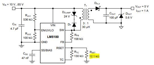

Could you tell me about RSET?
Data sheet recommends installing 12.1kΩ.
However, Customers want to use E12 series resistors.
What is the effect of using 12kΩ?
Could you advice on the recommended resistor accuracy and impact for RSET?
Yusuke
    RSET is used to set the reference voltage internally, if you use a E12 resistor which mean there is a ±10% variation, then there's at least 20% variation on the output voltage. It's highly recommended to use E96 resistor here.

    Let me ask you one more thing.
    Checking Equation 8,
    Vout is determined by the combination of Rset and Rfb.
    Why recommend 12.1kΩ?
    For example, when Rset is 12 kΩ, accuracy can be maintained by selecting Rfb considering 12 kΩ.
    s this understanding right?
    Yusuke
    From the datasheet, both I_REST and V_REST are tested under the 12.1kOhm condition, it means changing the resistor may have influence the both specs, so it is recommend to keep a 12.1k resistor.
