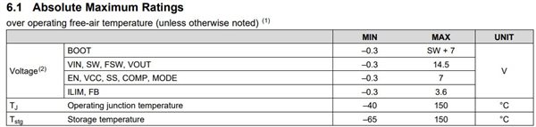

    Condition is :
    Vin=3.0V to 4.2V
    Vout=5V
    Iout=4.5A / 20sec~30sec ※peak current
    1. Customers are considering heat sinks to further increase output power.
     Do you have a design example using a heat sink or a heat dissipation sheet?
    2. During peak current output, device junction temperature is below 125 °C to 149 °C.
        Application is such a temperature condition only during the peak current.
     Will the life of the device be shortened if this operation is repeated?
    Yusuke

  • Hi Yusuke-San,
    If the layout is good. The maximum Tc will not exceed 90C.
  • Helen chen,
    Thank you for your response.
    "If the layout is good. The maximum Tc will not exceed 90C."
    It might be just as you say.
    However, customer application is small.
    Therefore, Tj is about 150℃@30sec.
    And Repeat the above operation.
    Does TPS61088 deteriorate if the temperature is below 150℃?
    Yusuke
