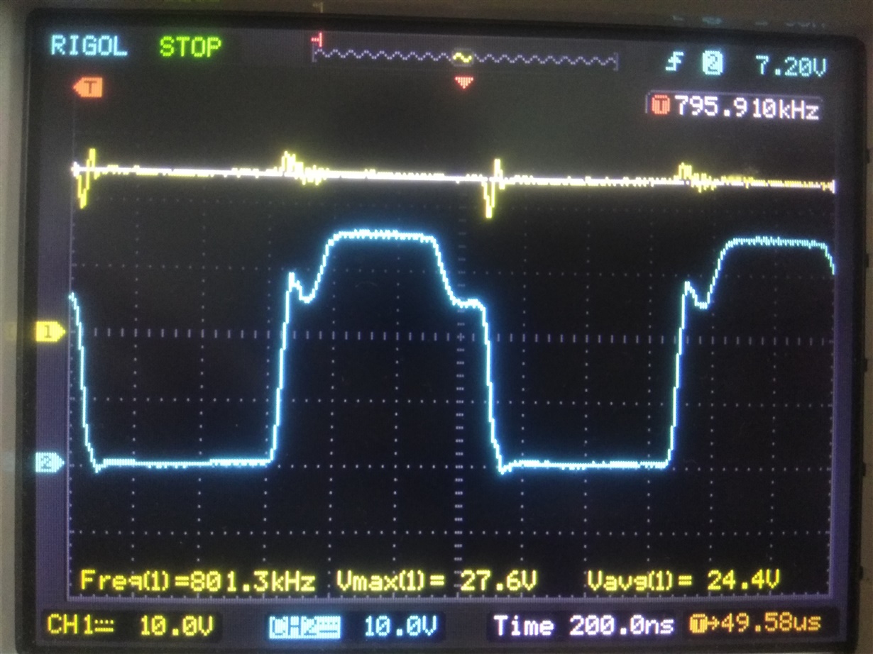

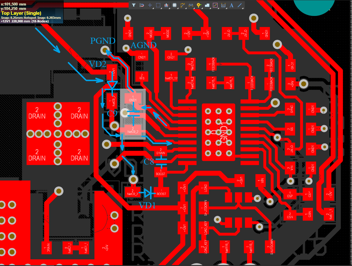

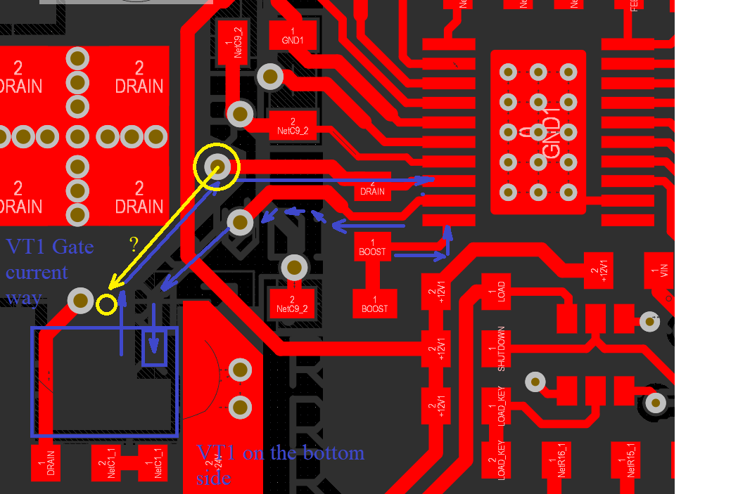

I'm sorry, but my load was't work correct. DC-DC behavior didn't change. Му be problem with VT1 gate current way?
  • Hi Anton,
    Sorry to hear that you are still having trouble. With regards to the previous image, HO should still not have a forward drop of 10V when you are conducting through the body diode to the SW. Do the scope shots that you've provided before match what you are seeing now, or has anything changed?
    As for the path- i think you should not have the 12V1 trace cut through the trace to VT1. Since that is an input rail, you could take a longer path around the FET.

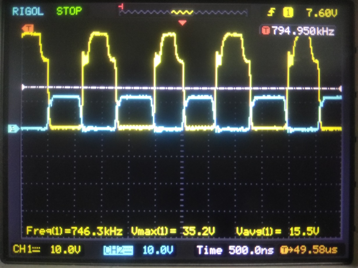

  • SW (top) and HO (bottom) signal respect to the groung are presented on this picture. At first HO signal is normal, but then gaps are appeared on the top of pulses. May be this behavor is related to power integrity? (DC-DC was under 3 Ohm load conditiion)

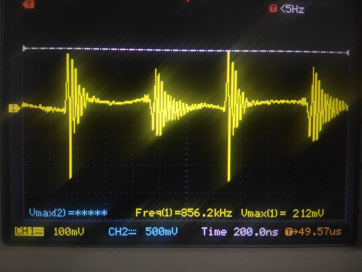

  • Hi, I have measured current signal on the current sense resistor before filter. It has strange form, but dc-dc works with off hiccup mode. Maybe it's related for EMC? (Load 4 Ohm) Are the current sense tracks not too long?  )

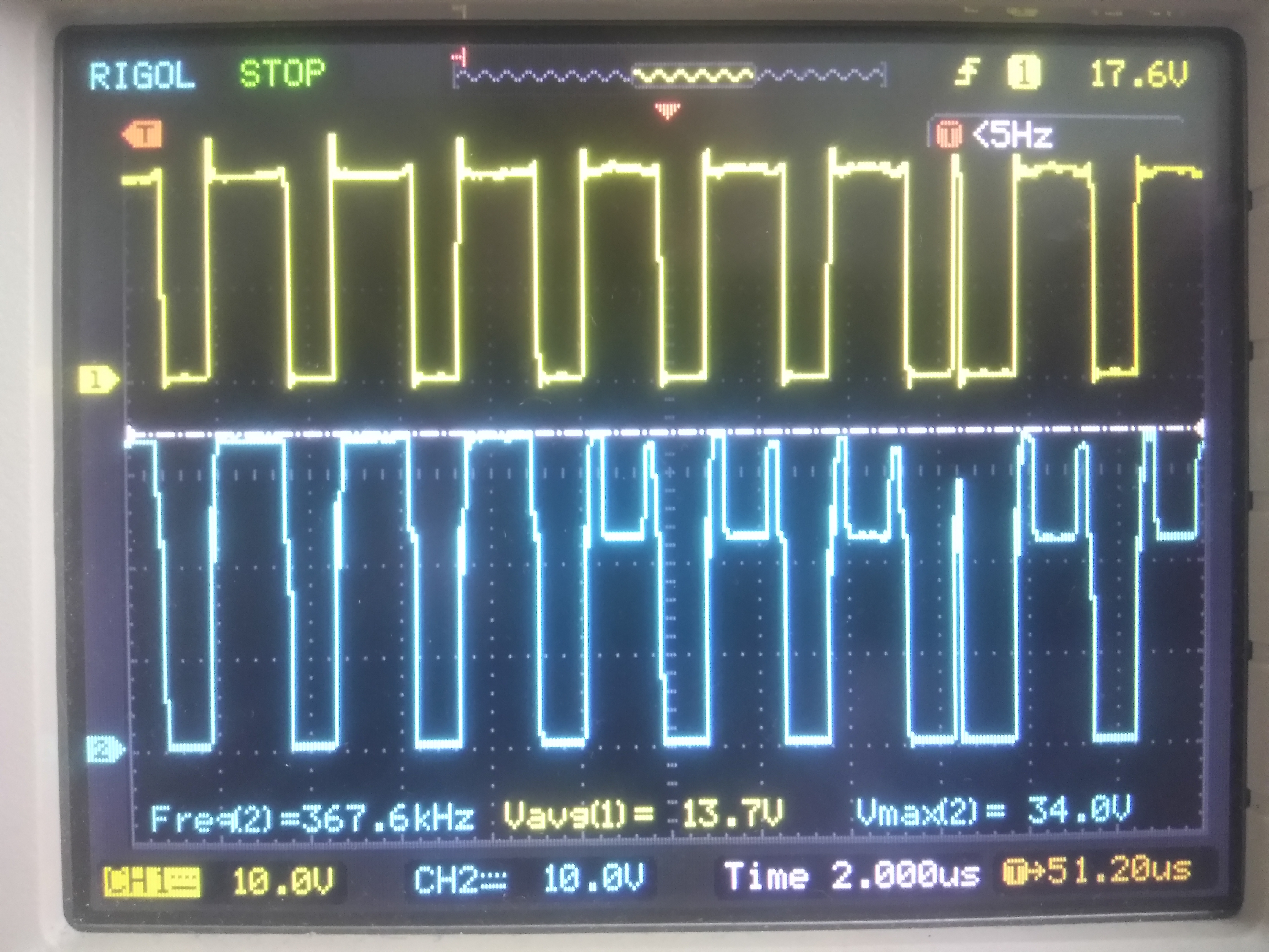

  • I made some scope shots. First shot is HO and LO when DC-DC under 3 ohm load. Hiccup mode is enable.
    I have solded 11 kOhm frequency setup resistor and 75 kOhm slope compensation resistor.But output voltage had spikes when HO was closing. And I redesigned current sense filter, 100 ohm resistor was replaced by 1,2 kOhm.

    Your current sense traces are too long, you will need to reorient your current sense traces to be shorter. In this case, I would recommend you to download the PSPICE model, and simulate your schematic to assess performance: http://www.ti.com/product/LM5122/toolssoftware
