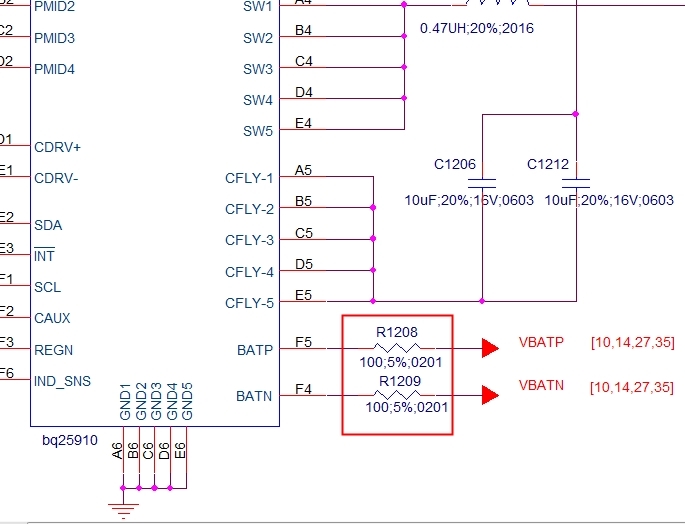

Could R1208 and R1209 be replaced by the PCB copper trace?
Hi Anders,
Please keep those two resistors, even if shorting these resistors will not impact any function.
These two resistors can help to improve robustness during battery plugin and ESD event.
