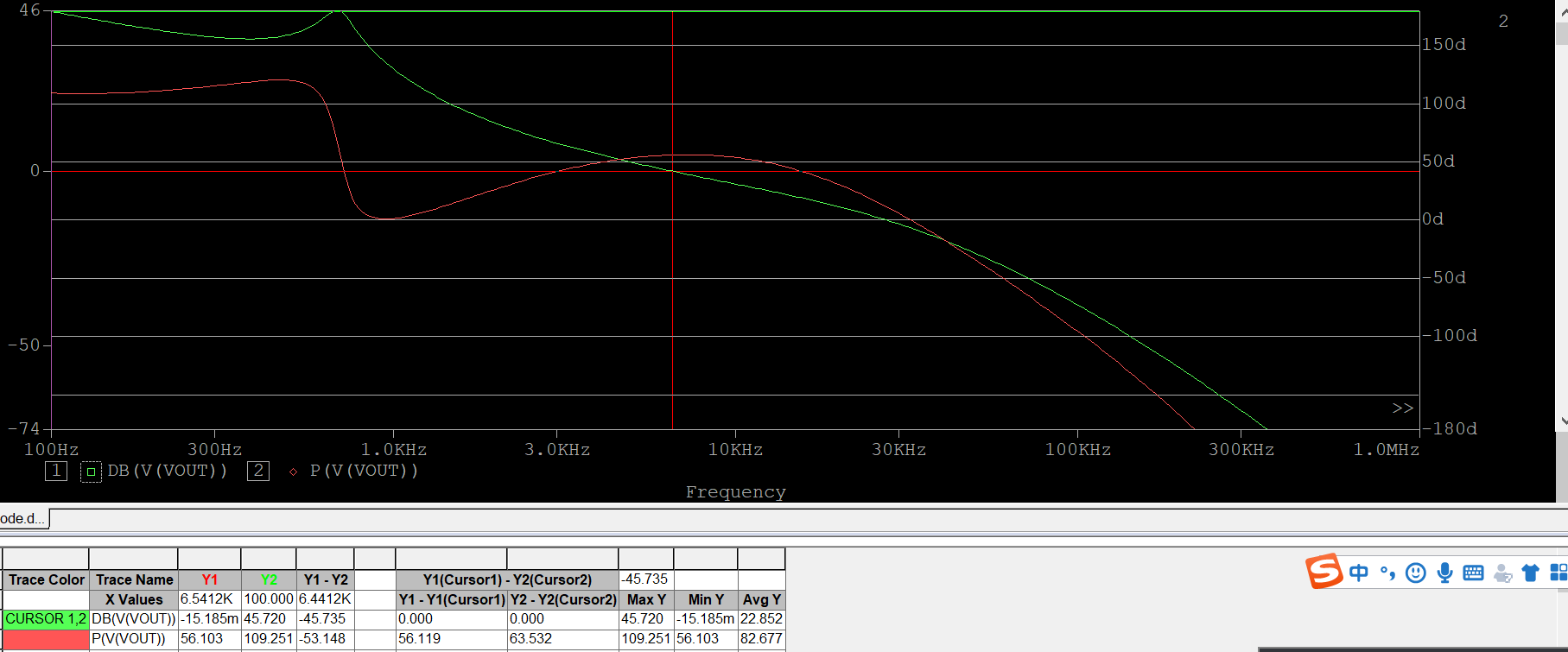

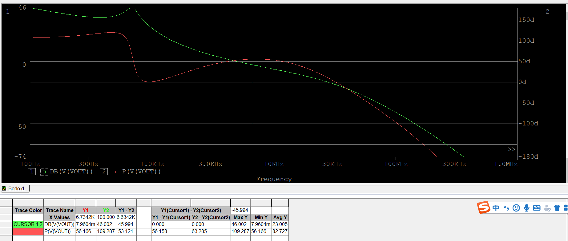

  • Hi Peter,
    Thanks for your reply.
    I will try to increase R50 value in the real test, but it seems no big difference from the average model simulation.
    R50=1K
    R50=4.7K
    R50=10K

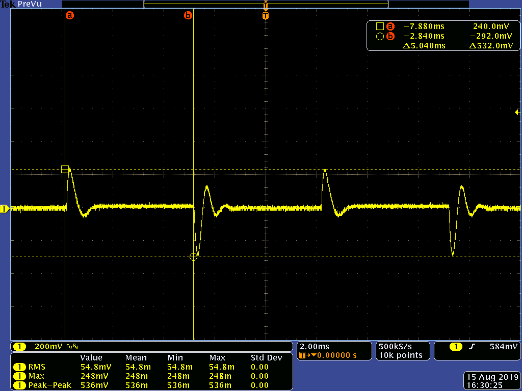

    also, the load transient waveform i shared in the previous reply was captured at the load side so that we see the DC level of voltage (AC coupled) is changing.
    here i attach the load transient waveform (AC coupled) which is close to the power supply output,  i think it is good from the perspective of loop stability.
    630Vin 2A to 7.5A_P24 ripple voltage

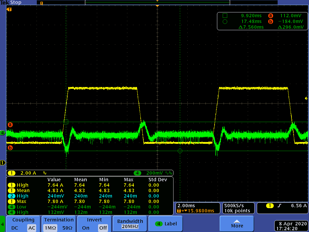

    The below is P24 voltage fluctuation (DC coupled) during load transient from 1A to 9A succefully,
    630Vin_1A to 9A_P24
    And the next chart show the failed load transient, you can see P24 doesn't drop too much during load transient, but due to the voltage of ILIM pin exceeds 0.5 more than 7.52ms, it shuts down the gating signals.
    565Vin_1A to 9A_P24_failed

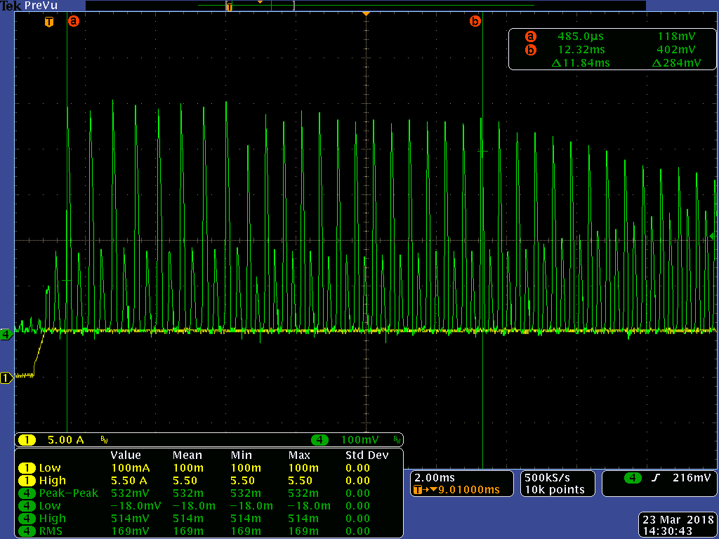

  • Hi Peter,
    Sorry for delay reply.
    i have tried to change R50 to 10k, and the test results showed that this power supply will still enter into hiccup mode when load transient from 1A to 9A with  12A/ms slew rate.
    Also I compared the load transient result with R50 =1k versus 10k, it seemed that the voltage overshoot and undershoot at R50 = 10k was worse.
    630V_2 to 7.5A_ R50=1k (please ignore the first step since it is from 0A to 7.5A and UCC28251 enters into OCP mode)
    630V_2 to 7.5A_ R50 = 10K
    Chengjun

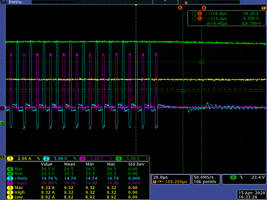

  • Hi Peter,
    I tested the high side and low side Mosfet gate signal instead of OUTA and OUTB during the load transient, it seemed that the duty cycle of gate signals were not imbalanced too much. it had the noise on the pin COMP indeed.
    630Vdc_ 1A to 9A_1 (1A/us, CH2 is high side gate ,CH3 is low side gate, CH4 is COMP)
                                                                              630Vdc_ 1A to 9A_2 (1A/us, CH2 is high side gate ,CH3 is low side gate, CH4 is P24)
    Chengjun
