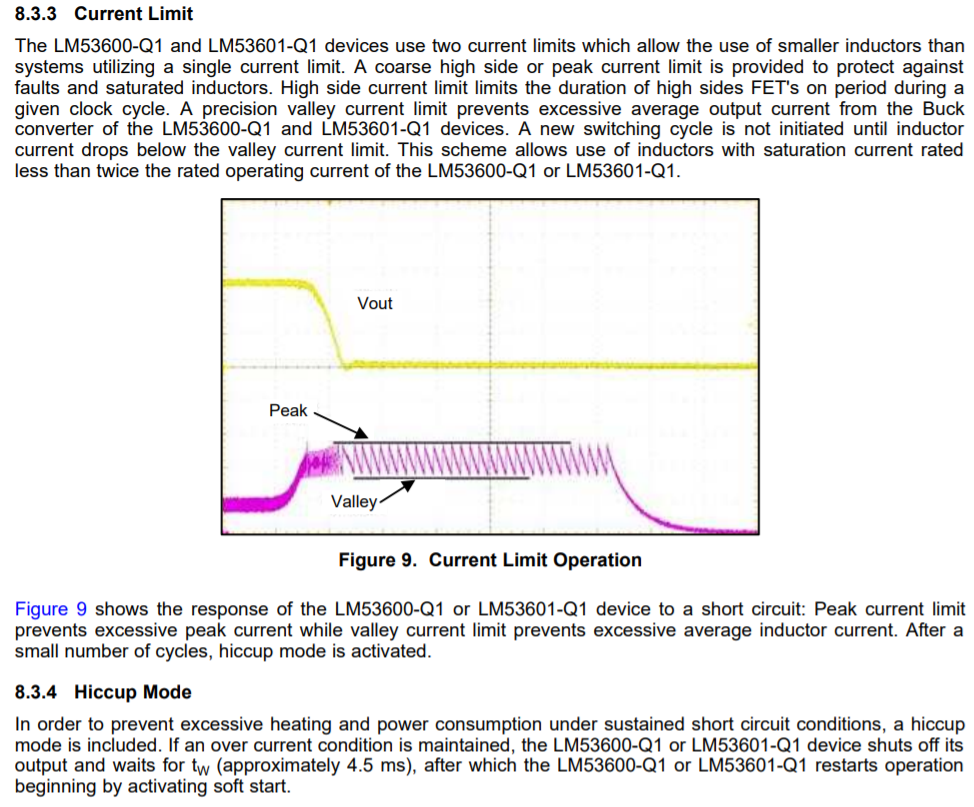

Hi Expert,
Could you please help share more details about the current protect mode?
I want to know the exactly current limit of the Peak and Valley. And after how many circle, the IC will enter Hiccup Mode?
Will be appreciated if you could share more detail about this Current Protect Mechanism
