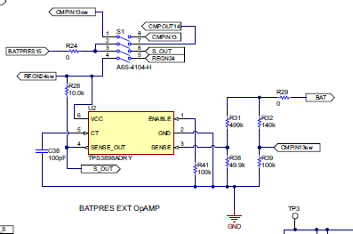

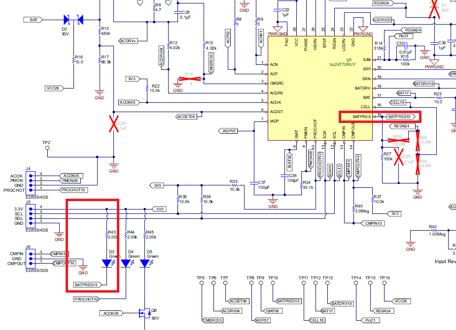

According to the datasheet, the PIN 15 of BQ24773 "BATPRES" is input signal PIN, but in the EVM I've found it seems to be output PIN.
If customer want to connect this pin to the MCU to indicate whether if the battery is present, how should they do?
