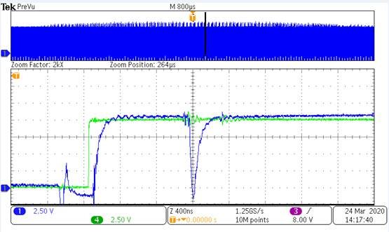

We have an issue in UCC21540. For below picture, CH1 is OUTA CH2 is INA and we use isolated probe to measure it.
You could see the OUTA suddenly drop but INA is stable. Do you have any idea how could debug it?

Hi Roy,
Thanks for your question.
I see some potential violation of abs. max values in the initial output undershoot which might cause poor performance. We typically recommend adding an external clamping diode if the undershoot is too bad.
I will reach out to you over email to learn more, since I think this will require more extensive information.
