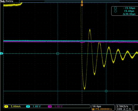

Hi TI experts,

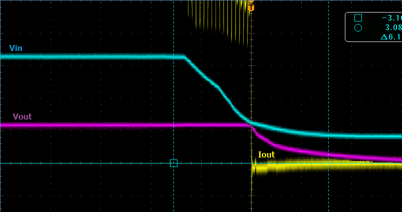

This waveform is a system power down situation. reverse current occurs for very short time.
1. Does this reverse current damage TLV755P(10~20mA, about 10us)?
2. i have seen that add a Schottky diode in the datasheet. Is there any other way to improve it?
Downey Kim.
  • Hi Downey,
    For question #1. No. This reverse current and magnitude will not damage the device.
    For question #2. If reverse current is a concern, another way yo solve this is to put a diode in series with VIN.
    I hope this helps.
