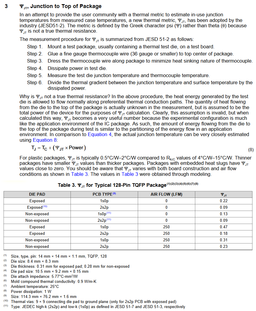

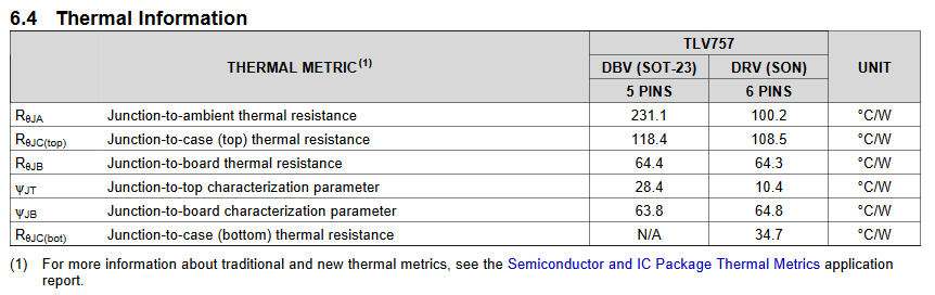

Could you please tell me the max ambient/package temp for this device if your team has?
From my understanding, the junction temperature is dominant and those values would change depending on the junction temp.
However, the customer is checking the thermal information for the package. So if your team has that information or reference, that would be very helpful.
