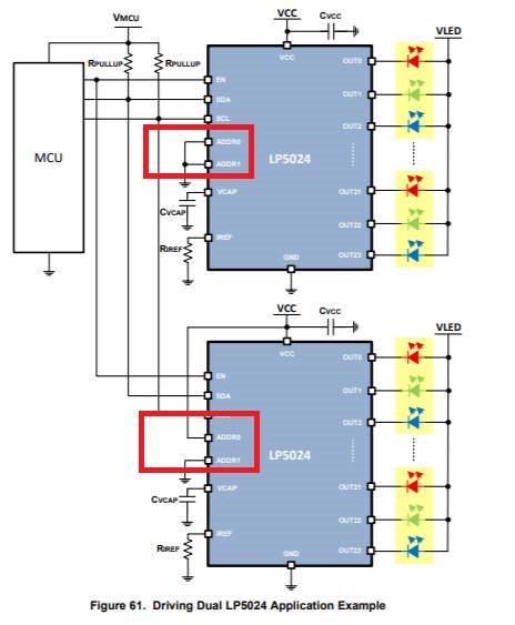

Hi Support team
my customer would like to use LP5036 to control more than 36 channel LEDs, as above reason, they need to adopt more than one LP5036, like 3 or 4 ICs,
however, may i know how many device could be controlled in one I2C?
  • Hi Red,
    Slave address of LP50xx family is defined by connecting GND or VCC to the ADDR0 and ADDR1 pins. Max to 4 independent slave addresses can be realized by combinations when GND or VCC is connected to the ADDR0 and ADDR1 pins.
