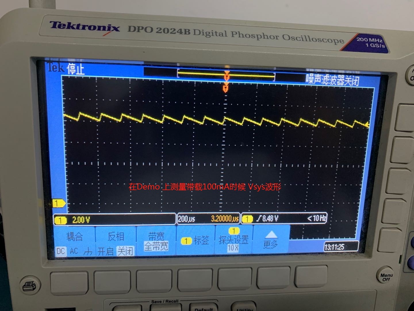

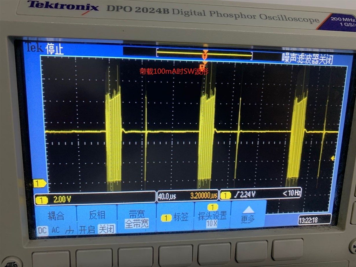

         We found that there are some noises in inductance after removing the battery from charge circuit. And at this point . The Vbus has powered the system (100mA load) sequentially. The phenomenon can find both in TI BQ25883 EVM and in our own bq25883 board. In the process of noise . The out-of-audio is in active and can TI help to guide how to solve the issue ? Thank you!
         The following picture is the convert waveform in the process of noise.
                                                                                                                       Picture.1 The waveform of Vsys
                                                                                                                   Picture.2 The waveform of SW

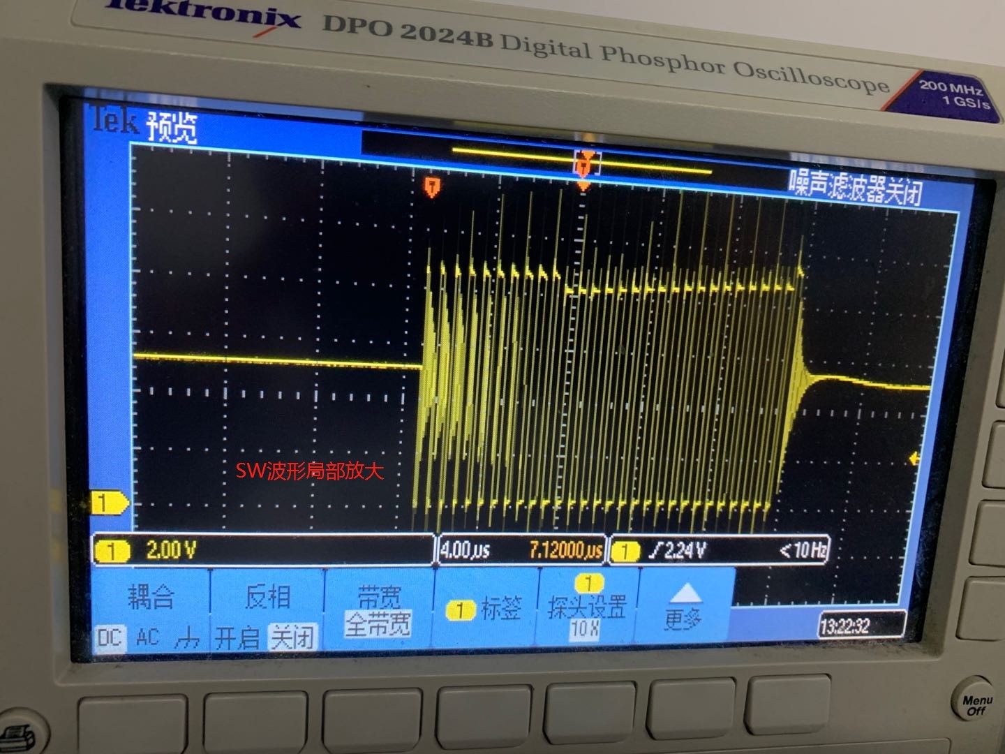

                                                                                                                                 Picture.3 The waveform of SW

    The first figure is demonstrating the charging and discharging of the BAT pin. Although there is no battery, there is still 10 uF of capacitance on the BAT pin and 44 uF on SYS. First, the charger charges the part to regulation battery voltage, approximately 8.4 V in your case. It does this quickly because the capacitance is so low compared to the capacitance of a real battery.
    Because the voltage of BAT is above MINSYS and charging is terminated, the SYS pin will be about 50 mV above the BAT pin. However, the SYS pin is still well above MINSYS, so the charger will not turn on to refresh it. In order to get the 100 mA of current, it draws from the BAT pin through D7 on the EVM.
    Once the BAT pin drops below the recharge threshold, the converter turns on to charge the output capacitance at BAT and SYS again. This brings BAT up, and SYS follows BAT up, albeit slightly above. This explains the triangular waveform you see on SYS.
    The waveform of SYS you are seeing is the PFM mode. As said above, the charger is turning on and off as dictated by the size of the output capacitance and the draw of the SYS load. PFM is used for light load and 100 mA SYS load with no battery charging qualifies.

    The key here is that you removed the battery charger from the circuit. The charger does not know that you removed the battery, and will treat the uF order level output capacitance as the battery and charge it as fast as you desired to charge the battery. It will discharge it through your system load and continue to do this "oscillatory" behavior until a real battery is inserted and a more "normal" charging cycle can start.

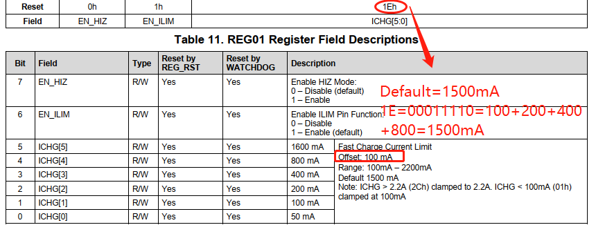

             Thank you! The charging can be stopped now and the noise disappeared. But there are still three issue we meet again.
             1.The Ichg offset seems to be 0mA rather than 100mA which mark in the specification
             2. We found the Vsys is inexact when we disable charge in both of EVM & our borad. In our test. The Vsys is 6.98V (with 100mA load) while the SYS_MIN is 6.8V which set in REG07
             3. We found the charge efficiency is too low in our board (Vin=5V/Ichg=960mA/Isys=30mA). Do you help some suggestions to improve the efficiency
            Thanks!
