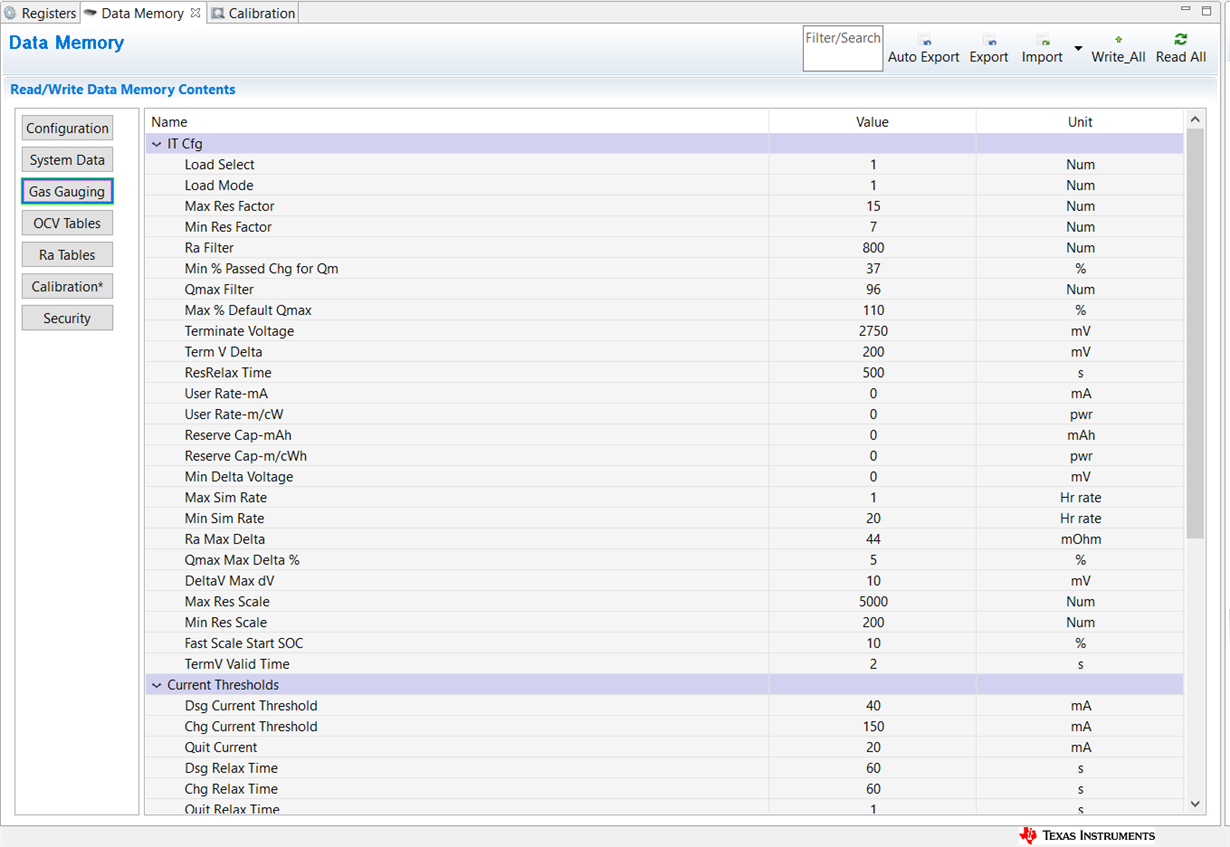

    Thank you for your help! Turns out we were overlooking the very important configuration and learning cycle steps. I now have an ev2400 and a bq27510EVM. I performed the Chem ID test selection process and matched to an ID of 1289 with a max deviation of 1.7%.
    However I am now struggling with the the first charge step in the learning cycle as the FC bit never sets. I have played with the Taper Current settings - first setting it to 200mA but the charge terminated around 268mA, so i increased my taper current to 280mA. I then repeated the whole process of discharging then recharging and the charge terminated again before setting FC - ending at an average current of about 368mA (see graphs below and screenshots of settings).
    Is there something I am missing?
    1) Does current calibration need to occur before learning cycle (there is a mismatch between what my power supply's measured current and that reported by the gauge when charging).
    2) does it seem to be a charger configuration issue? (We are using the LTC4162 charger (DC2038A eval board) with its default settings)
    3) Improperly set fuel gauge settings affecting charge termination or accurate detection of termination

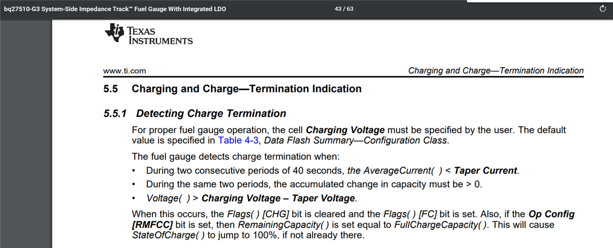

  • You need to taper longer. You are not tapering appropriately here. Make sure to refer to primary charge termination conditions in the TRM for more details on how the FC bit works.
  • May you be more specific about what is "appropriate tapering" ?
    Looking at the reference manual the only terms mentioned in relation to determining charge termination is "Charging Voltage", "Taper Current", and "Taper Voltage". Nothing specific on tapering.
    It is taper current and taper voltage. Those are the parameters you ahve to set for RSOC 100% and also FC bit setting.
  • As I myself mentioned in the reply above I am aware that these are the parameters I have to set; However, I am not aware how to set them "appropriately".
    I'm just trying to get clarity on what you meant earlier by "You are not tapering appropriately here"
  • Oh, set taper to the battery cell spec sheet.
    You want to typically taper at C by 10 or lower.
    Taper voltage needs to be set 100 mV from your CV voltage. If you CV at 4.35 V, you set this to 4.25 V.
