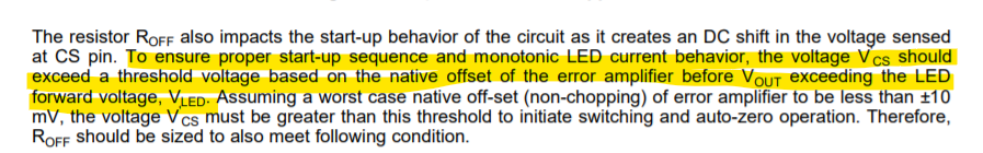

Hello Ryo,
Have they implemented the offset resistor as described in the datasheet?
What are the steps they are taking and when does the issue arise? Are they dimming down via Iadj until the LEDs extinguish?
