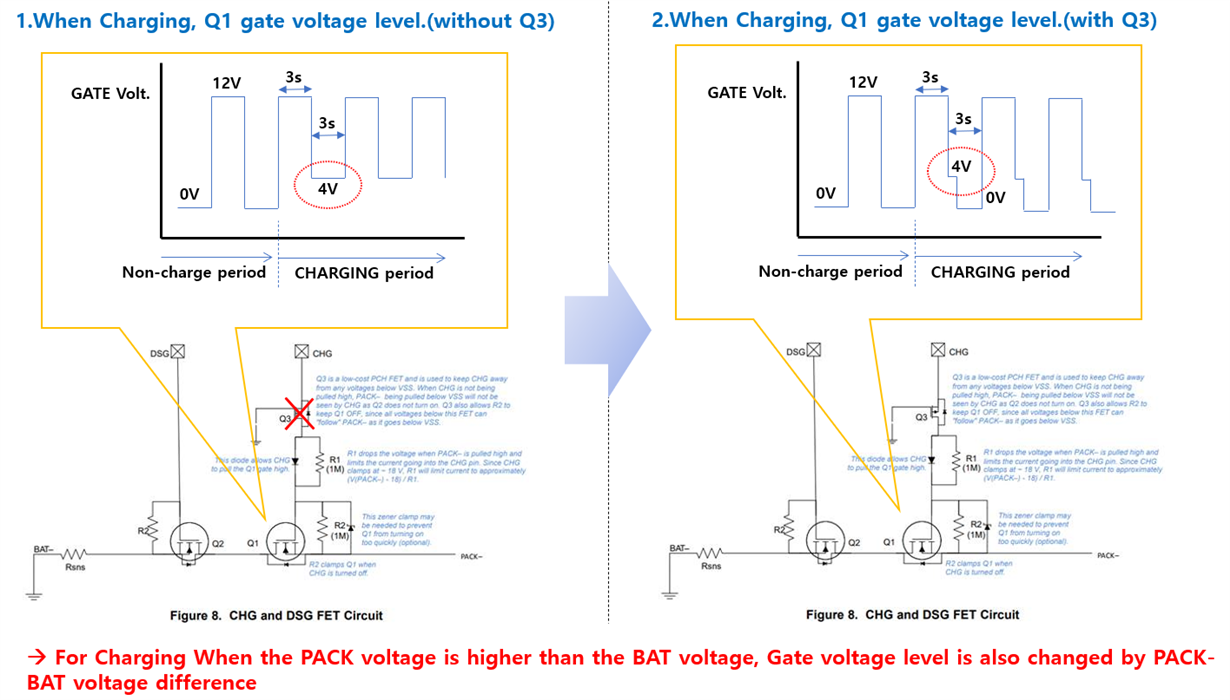

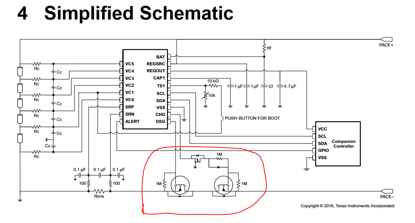

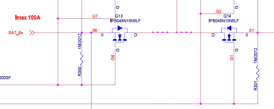

Dear Sir,
When charging BAT PACK. Q1  N-MOSFETs are increase Temperature and very hot.
When TURN OFF Q1  N-MOSFETs. GATE voltage is 4V.
When TURN ON Q1  N-MOSFETs. GATE voltage is 12V.
If BAT CHARGING Voltage and BAT PACK are same. When TURN OFF Q1  N-MOSFETs. GATE voltage is 0V.
BAT CHARGING Voltage : 84V
BAT PACK voltage : 70V
could you let me know advise me about this issue.,
please refer below wave form.
3250.LOW-SIDE FET_gate voltage abnormal.pptx
