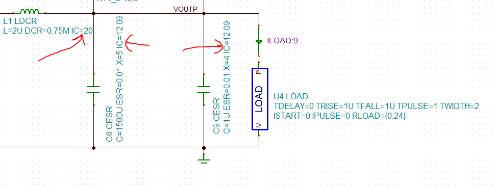

I am working on UCC28950 Steady State Reference Desing  simulation and I try to simulate  my 2kW  dc dc converter design using this reference design simulation.
Here I have a question about UCC28950 Steady State Reference Desing .
- In the output of dc dc converter, there are output inductor(Lout) and capacitors(Cout). These capacitors and inductor have IC value . For example , (Lout= 2U DCR=0.75M IC=20
-What is the IC ?
-What is the importance of IC value for bobin and capacitors?
I attached below related circuit picture from  UCC28950 Steady State Reference Desing  simulation circuit.
  • Hello Bilgin
    In this context 'IC' means Initial Condition. This is the value that the simulator assigns to the component at the beginning of the simulation. It means that the simulation gets close to its steady state condition more quickly than it would if the initial condition were set to zero.  Normally one would set the IC for the capacitor to be the regulated output voltage and the IC for the inductor to be the load current.
    Colin
  • Hello Colin
    Thanks for your reply.
    For example , in my 2kW  dc-dc converter design at full load output is 32V ,62 A.
    -In this case my Cout capacitor has IC=32 , at full load my Lout bobin has IC=62 . Is it OK?
    Also,when I simulate the transformer in steady state solver , this simulation results are changes and results(Vout,Iload) nearly equals to zero.
    I know UCC28950 model is transient model and it can be simulated in transient mode but, I have a question.
    - How can I simulate this circuit correctly  in steady state solver or steady - state mode?
    Thanks.

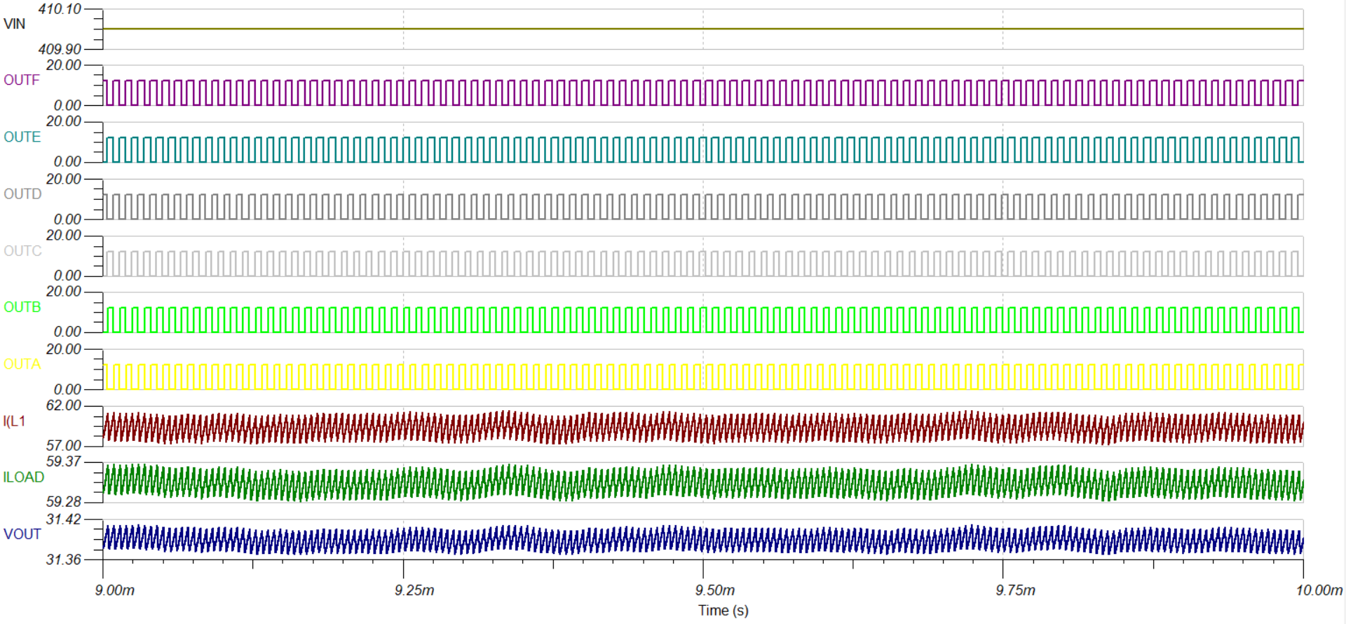

  • Hi Colin
    Thanks a lot for your valuable informations.
    I changed dead times , input and output capacitances and L2 values according to your values . I looked at the sim file 9ms to 10ms time period.
    Finally , output voltage is between 31.36 V and 31.42 Volt and Load current is between  59.28A  and 59.37A.  I've been able to run my sim for my desired
    output voltage and current level.  Thanks for your help.
    As far as I understood , the main problems are in Lout , current burden resistor and both the shim inductor and the transformer primary leakage inductance.

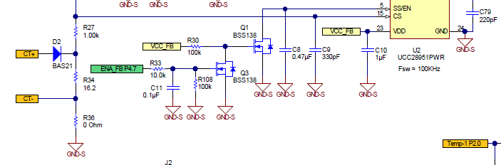

    In PM8740 dc- dc converter schematic ,  CT burden resistor is 16,2 ohm and reset resistor  is 100k. When I used these values output voltage and load current are significantly reduced.
     I have question about CT burden resistor and reset resistor . How do you  calculate  CT burden resistor 7R  and reset resistor 700R values?
    Also , Full bridge transformer and shim inductor are custom design  transformers and  I have no informations about their leakage inductances.
    How can I adjust these values ?
    I attached the my sim file results and pmp8740 dc-dc converter currrent sense transformer circuit below.
    Thanks.
  • Hi Bilgin
    It's great that you have made some progress. I put in 7R as a burden as a guess to get the sim running and it worked. I'm still trying to figure out a couple of things - and I'll post here later. If you get a chance, can you post your sim file here too so that I can run it for myself.
    Colin

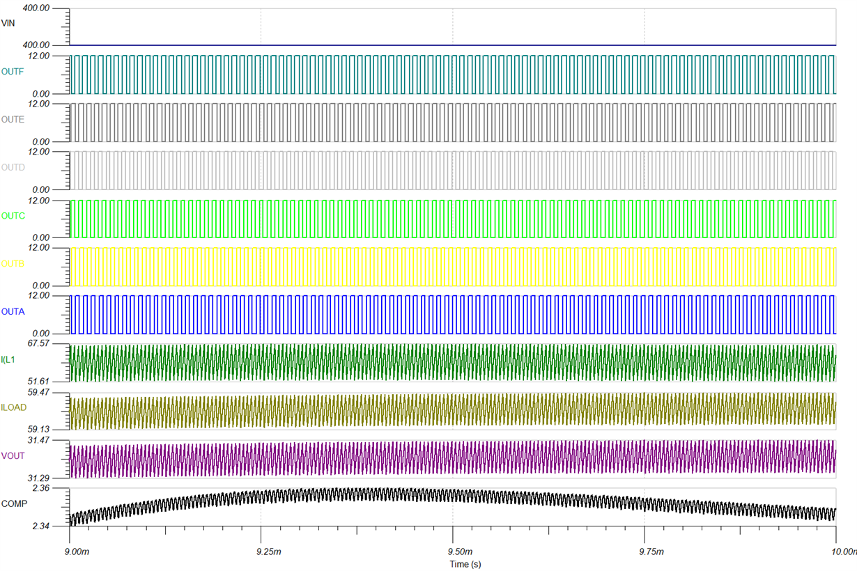

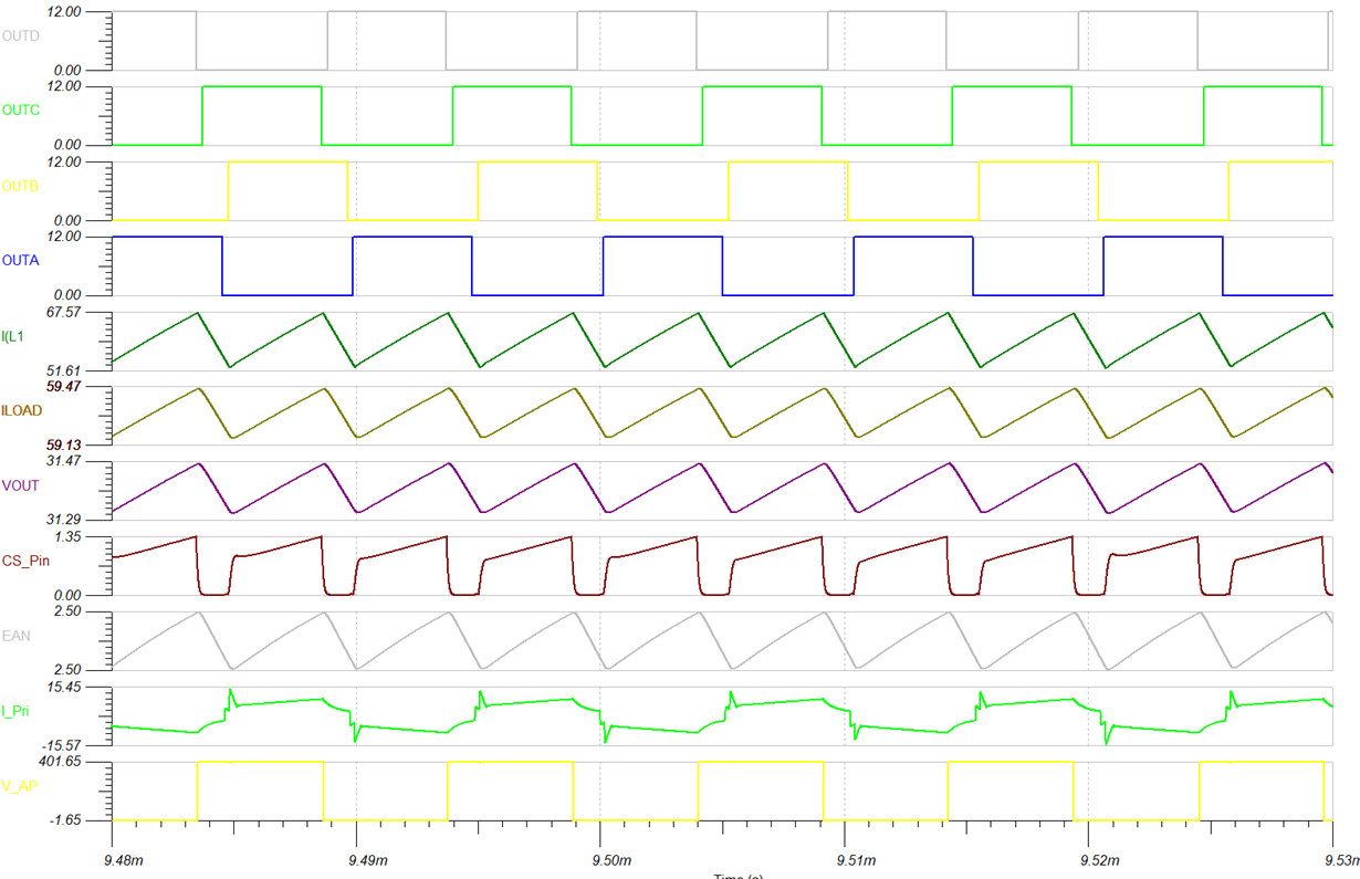

  • Hi Bilgin
    I think there may be a problem with the MOSFET models - I was getting very large input currents and having problems getting Vout to be correct with reasonable accuracy. I changed the MOSFETs for voltage controlled switches and replaced the SRs with diodes. The sim now works - I attach the sim file. Here are a couple of screen shots too - Vo is ok, the output inductor waveform is ok as is the primary current. The dead times may not be optimum but that may be a fuction of the switches - you might want to add 200pF across each of them.
    I'm not sure that the loop is completely stable - you can see that COMP is following a curve - possibly part of a damped sinusoid.
    /cfs-file/__key/communityserver-discussions-components-files/196/2kW-dc_2D00_dc-converter_2D00_2.TSC
    I'm going to put this to one side for now. Please let me know how you get on and if you have any further questions.
    Colin
