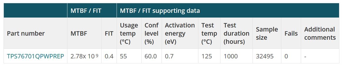

    I would like to confirm also that the life test (1000 h) was done at Tj=125ºC. It is not specified if it was Tj or Tc, even if it is inferred by the device type.

    The temperature that the life testing was conducted at was 125C.

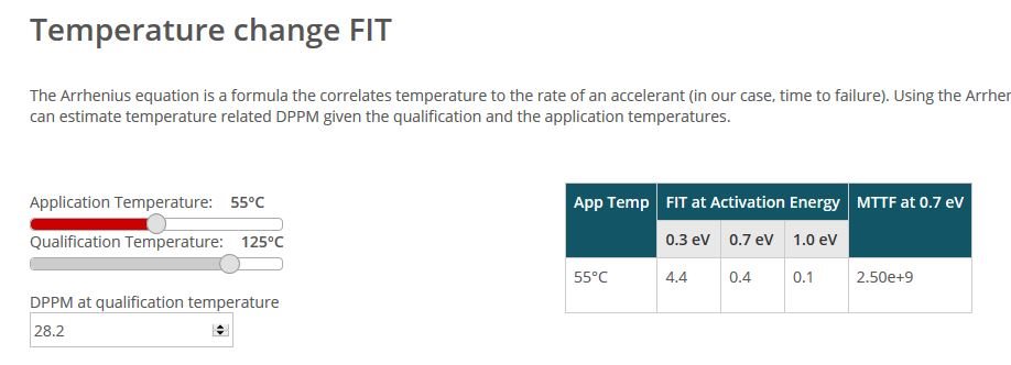

    On the other hand, for the temperature change FIT calculator, I would like to check which DPPM should I write to make the calculations; I wrote 28,20, value given considering 32495 on sample size and 60% CL, on http://www.ti.com/support-quality/reliability/DPPM-sample-size-calculator.html,
    The figures I obtained on your calculator  differ slightly  from the ones applying Arrhenius to 0.4 FIT @ Tj = 55ºC

    I looked at the Arrhenius calculator and I think I see what you are seeing.
    I set the Application and Qualification temperature sliders to 125C.
    When I type in DPPM = 0.350000001 I get MTTF = 2.5e+9.
    When I type in DPPM = 0.35 I get MTTF = 3.33e+9.
    It's almost like there is a lookup table, and it uses the entry in the DPPM box and rounds to the nearest value.
    I would use this calculator as an estimate but the value in the qualification data is what is accurate.
    Here is how I entered the data - again, I think the online tool is probably using a lookup table.
