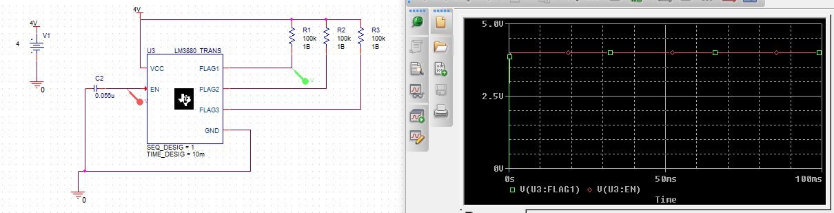

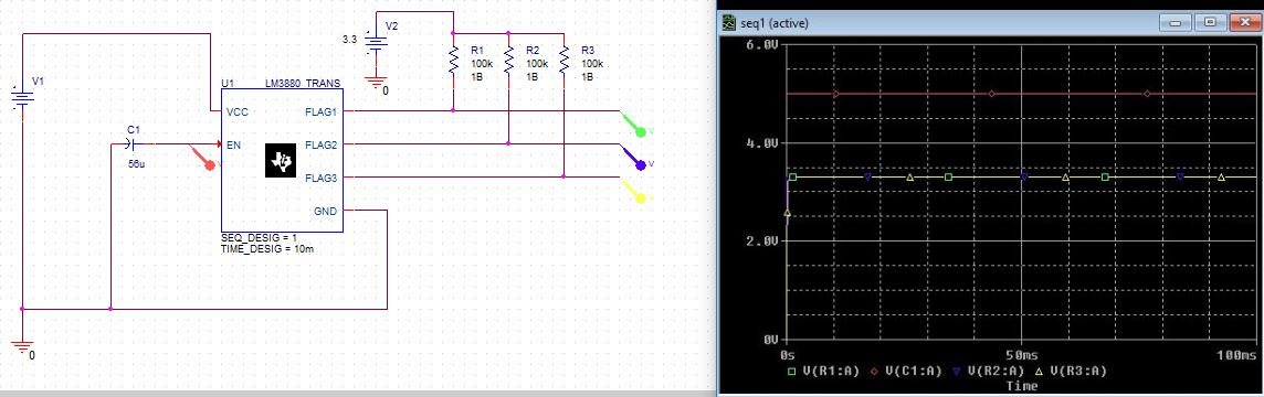

when simulating the LM3880 sequecner i obtained those results , i was supposed to have three power-up sequences after 10ms because the value of C1 is designed such as
the EN pin set on after 10ms according to the datasheet of LM3880. i did the right schematic circuit as in the datasheet . why didn't i obtained the right results ?
