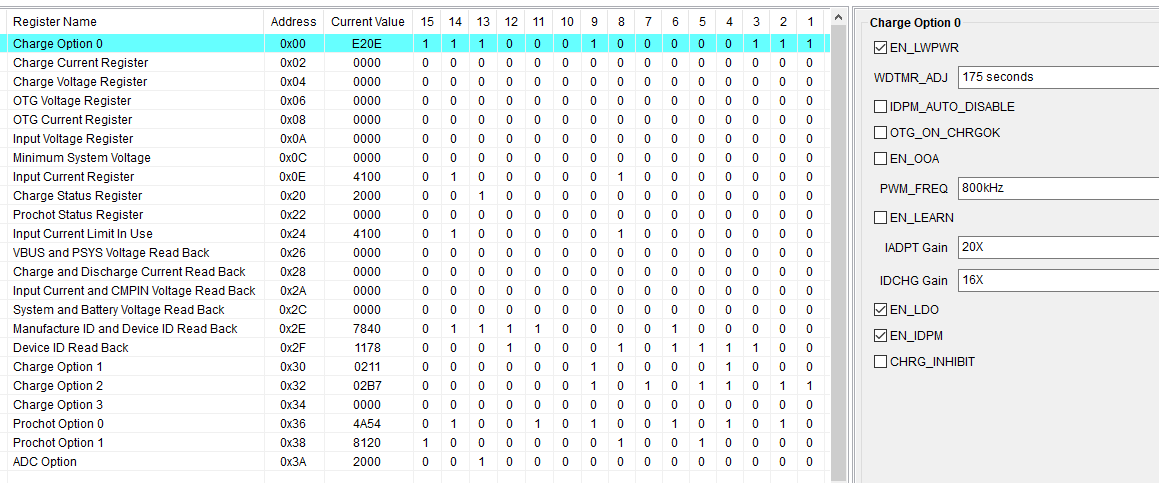

Hello Sir
In spec, page 10, quiescent current, when VBAT = 18 V, REG0x12[15]= 1, in low power mode  battery quiescent current is between 22 ~45 μA
in page 26, 8.3.8.1 PROCHOT During Low Power Mode
During low power mode (REG0x12[15] = 1), the charger offers a low quiescent current (~150 μA) Low power
PROCHOT function uses the independent comparator to monitor battery discharge current and system voltage,
and assert PROCHOT to CPU.
The quiescent current is different in these two description, can you let me know which one is correct?
