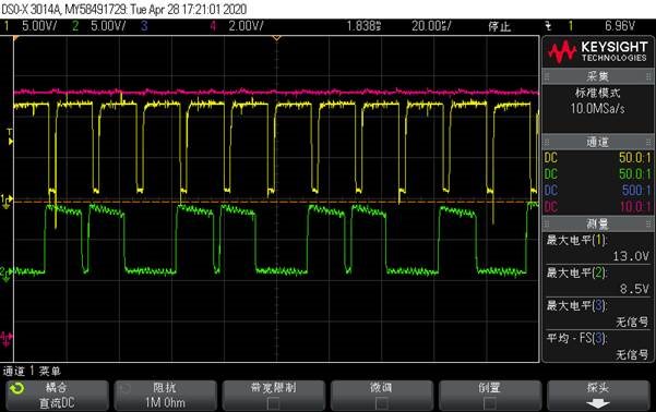

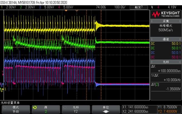

We find that when UCC27714's top temperature reaches 70C, the HB-HS voltage will drop to below 7V, causing UCC27714 to restart repeatedly.
The waveforms are as below:
yellow- good bootstrap cap voltage waveform(UCC27714 whose temperature is less than 70C)
blue- good HO-HS voltage waveform
green- bad bootstrap cap voltage waveform(UCC27714 whose temperature is above 70C)
red- bad HO-HS voltage waveform
The device power supply is stable, and we've tried to replace the device and the problem is still there. Within the same device, if we cool down the temperature to below 70C, the problem disappear.

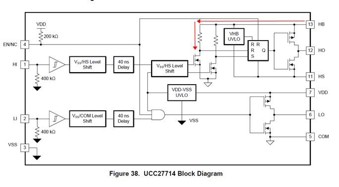

Are there any internal circuit that could discharge the bootstrap capacitor during high temperature? For example the red line shown below?
Are there any risk for the schematic we provide?

    Even when the switching stops, the green waveform looks much lower during the high temp example than the "good waveform". Is the yellow and green waveforms ground reference the same, and same voltage scale?

  • 1. we've decreased Rboot to 1.1ohm but it doesn't help.
    2. Dboot is STTH110A
    3. 70C is measured by thermocoupler attached to the top of the IC. VDD is +12V, switching frequency 60kHz, single MOSFET IRF300P226(NO Parallel). Gate drive resistor is 10ohm. Maximum duty cycle is 90%.

    But still curious why it can solve the problem. We have measured the waveform with original cap value when HB-HS voltage will drop, the VDD voltage is very stable as shown below purple line

    It is good news that the changes resolved the issue. It is not clear exactly why this is happening,. The 4.7K resistance on the Vgs will result in more current draw than the IC HB should have. The temperature of the IC junction we confirmed should not be an issue.

    In the last post i said"They changed the VDD cap to 4.7uF, and boot cap to 0.47uF and the problem solved."
    In fact, They have tried CVDD=0.1uF, and boot cap to 0.47uF, and it also works.
    But if they use CVDD=0.1uF, Cboot=0.22uF, the device won't pass HI to HO at the startup.
    So it seems that only Cboot is determine whether the circuit could work or not, it's not a must that CVDD to be 10times larger than CBOOT.
    Why too large or too small boot capacitor will result in abnormal working?
