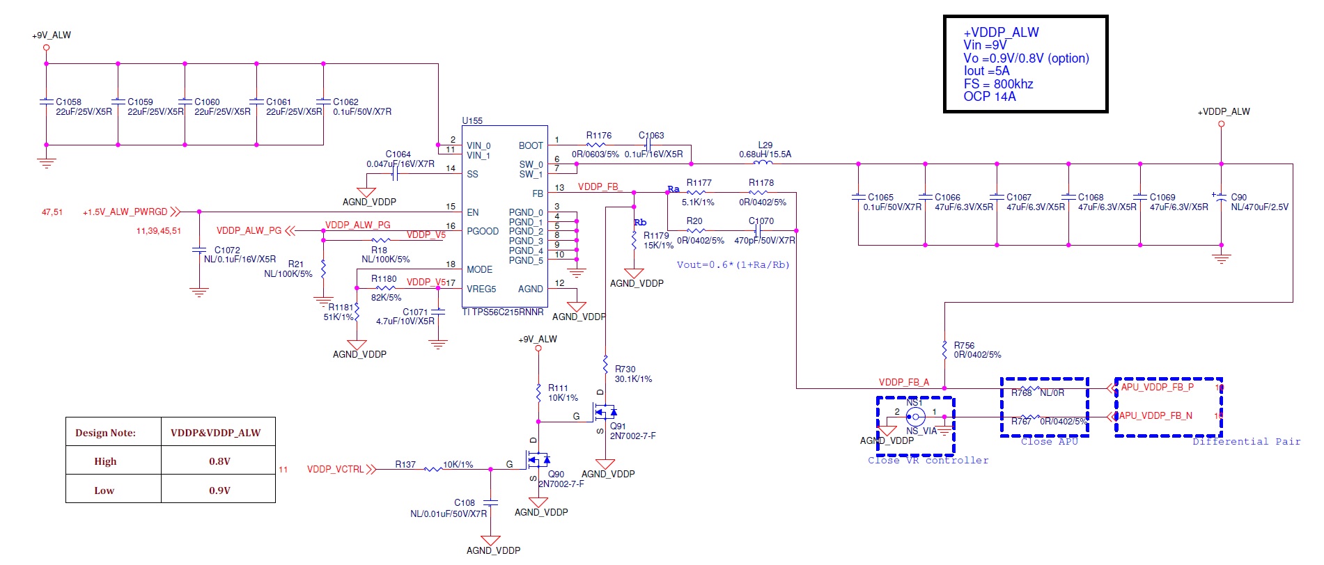

Hi team,
Could you help check the TPS56C215 schematic as below and any need to adjust?
Thanks!
Two comments for reference.
Recommend to add one more input 0.1uf cap, put 2x22uf+0.1uf each for pin2 and pin11.
Make R20/C1070 NC as default.
