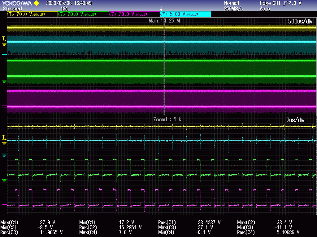

    with good board, 0.025A input current, the waveforms are:
    yellow-Vin, green-CB, purple-SW, blue-5V out
    with bad board 0.075A input current, the waveforms are:

    The waveforms show me that the device is switching from DCM frequency foldback mode to CCM to compensate for the increased load, presumably being dissipated in the inductor and diode. But I'm not sure how those waveforms would cause the diode or inductor to overheat.
    How much hotter are the inductor and diode on a bad board compared to a good board? And does this change with load?
    -Sam

    For the waveform for higher input current 0.075A, it seems that SW be below -1V. Is it purely caused by the diode?
    But we are not sure "SW below -1V" is the cause or the result since good board SW won't be below -1V.

    Yes a damaged diode could be the reason the diode gets hot and the SW pin gets damaged. Try depopulating the diode and check it against a good diode. Is the forward voltage the same? Is the reverse breakdown the same? Is the leakage the same?
    A damaged/broken diode would be the cause of the SW voltage going lower than typical. This can damage the IC and cause the diode to overheat.
    The diode could get damaged from violating abs max in the diode datasheet. It's rated for 60V and there's only 32V in the input. Though the input cap loop is large so the SW ringing may be excessive. Check the SW node with a 500MHz+ scope without bandwidth limit to see if there's excessive ringing.
