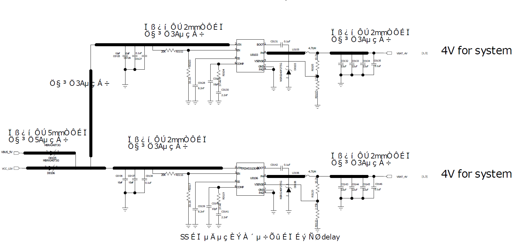

As below picture, we designed a circuit with 2pcs TPS54531, which input power is 5V or 12V ,and output power is 4V.
when we received the PCB , we found the out power of TPS54531 is unstable, changing from 2.6V to 3.6V, could you help have a check for this issue? thanks a lot.

    Could you please clarify the condition in the waveform you showed? What is the input voltage? What is the loading? Does 12V input voltage works normal?

  • Thanks Bruce,  I update the picture of curve, and the issue need be updated as below:
    1) if set the input power below 5.2V, the curve of output power will same as the forward attached picture.
    2) if set the input power above 5.2V , the output power will be OK, 4V and stable.
    so we think the issue should caused by the efficiency of this circuit,  maybe caused by Circuit matching?

    TPS54531 is a non-sync converter and cannot support large duty applications actually. You can add a diode from Vout to BST or use a sync converter like TPS56637 for this 5V-4V application.
    For detailed explanation, please refer to the same question from
    Please let me know if any further support needed.
