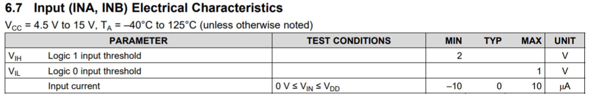

Dear Team,
The customer is facing the driver will output the wrong signal during the surge test.
So do we have higher threshold voltage or we have circuit can prevent interference during surge?
Customer will prefer P2P, with 4A driving capability.
If no P2P is also welcome.
BR
Kevin

    A solution to try is adding a filter on the inputs such that Rin <= 100-Ohms and Cin <= 300pF to prevent the false triggers.

  • Hi Kevin,
    In that case, UCC27524 might be a better option: different input structure (hysteresis and active pull-down on the input stages) while UCC27324 consist of a MOS-gated input stage and does not offer hysteresis on inputs therefore is susceptible to false turn-on when the driver is subject to noise or surges.
    The devices are p2p and UCC27524 has higher drive current 5A and wider VDD range 20V abs max.
