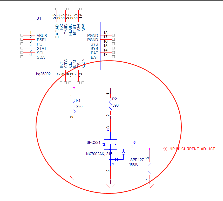

Dear Sir:
         For the BQ25890H, when the device power off and charge the battery,
we set the input current limit to 1A by ILIM which the Rilim is 390 Ohm,
When device boot, could we re-set the ILIM to 2A by add a parallel resistor?
Like below picture, shown with red circuit.
Thanks!
