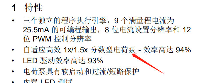

LP55231: LP55231 this internal charge pump, under what circumstances will switch to 1Xmodes
Expert 2630 points
Part Number: LP55231
  • Hi 2018,
