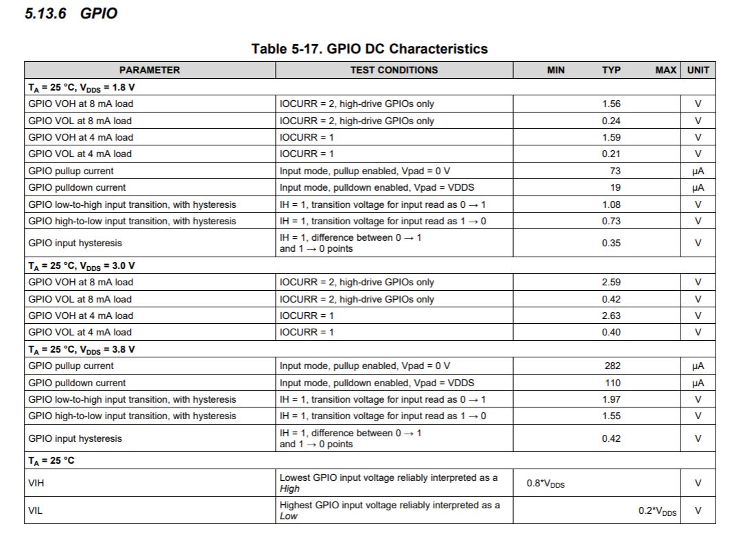

    I checked CC2642R datasheet. I didn't find the 0.66V for low level. Did you measure it?
    According to the datasheet, it seems OK if just connect EN to the GPIO. But as I'm not familiar with MCU, it's better to double check with MCU team.

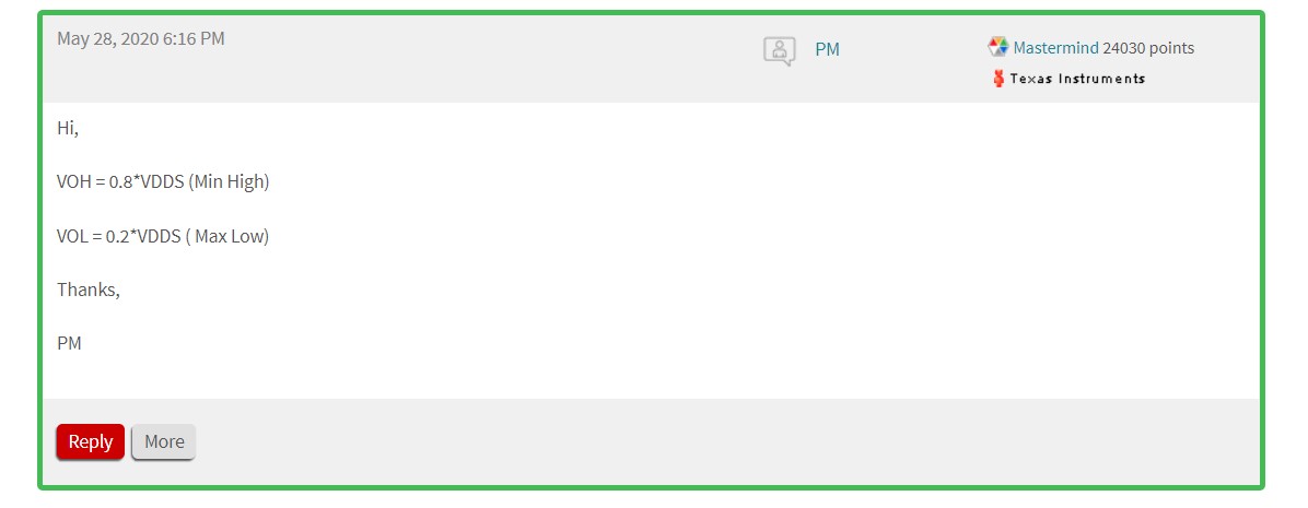

    My MCU CC2642R VDDS is 3.3V. Therefore, 0.2 x 3.3V = 0.66V.
    I knew it from another CC2642R post. It seems like VIH and VIL are the same as VOH and VOL respectively. I have a doubt on this too. VOH and VOL can't be found on datasheet at 3.3V supply voltage.
    Can double check on these VOL and VOH values?

  • David, do you have the link to the E2E post you found about the VOH/ VOL levels? From how I read the datasheet I believe the answer you found is not correct.
    First, VOH/ VOL will be very close to VDD/ gnd if you don't load the DIO. The data in the datasheet is measured with the max current the DIOs can deliver. If you look at VOL with 4 mA current the VOL is 0.21 V @ 1.8 V and 0.40 V @3.0 V which is less than 0.14*VDD.
    I assume that you are not going to draw 4 mA from the DIO when you are using this as a control signal meaning that the VOL will be lower than 0.14*VDD.

  • I looked closer at the number and it looks like the spec (input to R&D) is 0.2*VDD/ 0.8*VDD as min/ max VOL/VOH when sourcing/ sinking 4 mA/ 8 mA. The number in the datasheet is typical.
    The typical for VOH (4 mA source) is 0.88*VDD. If you are using a pull-up the current draw will be a fraction of this and VOL/ VOH will be much closer to the rails.
