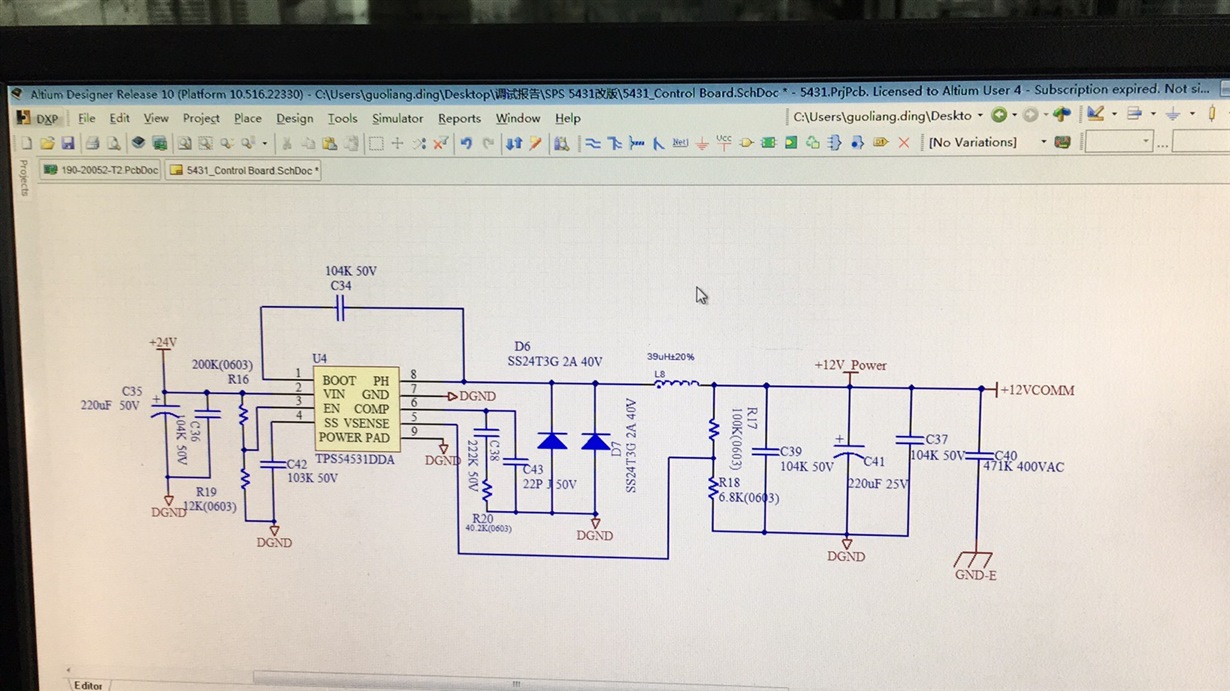

My customer found an issue of output droop when powering up using TPS54531, could you please help analysis? Thanks.
The schematic is as below, the input voltage is 24V, output voltage is 12V.(+12V Power and +12V COMM),and +12V COMM is for MCU power supply and 5V auxiliary power supply. +12V Power following additional capacitors.

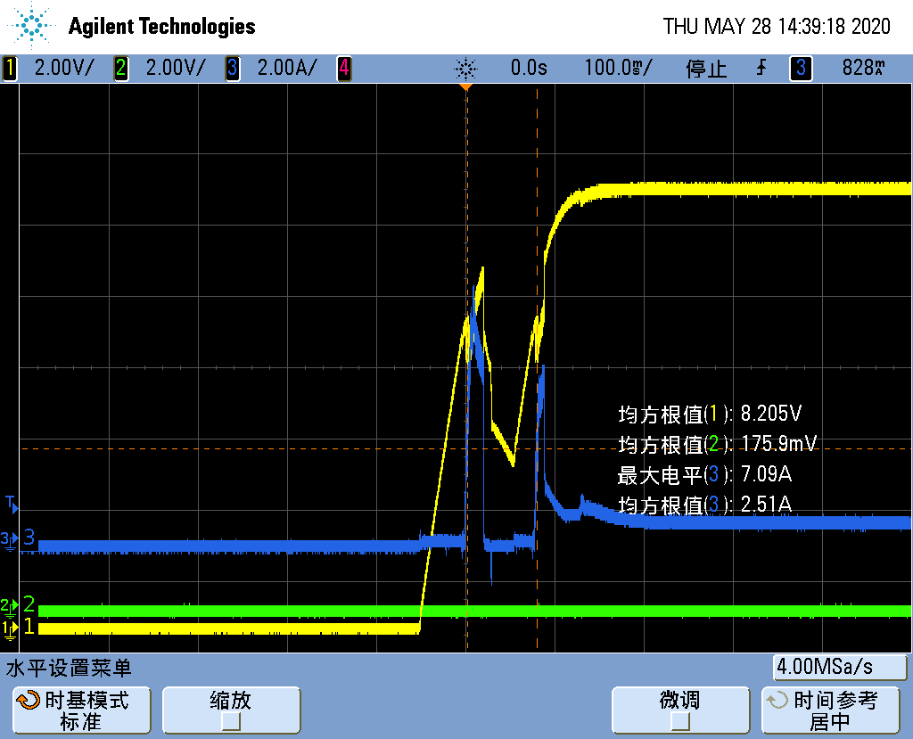

CH 1:+12V Power CH2:+12V COMM  CH3:Total output current
Below is using 10nF Css capacitor

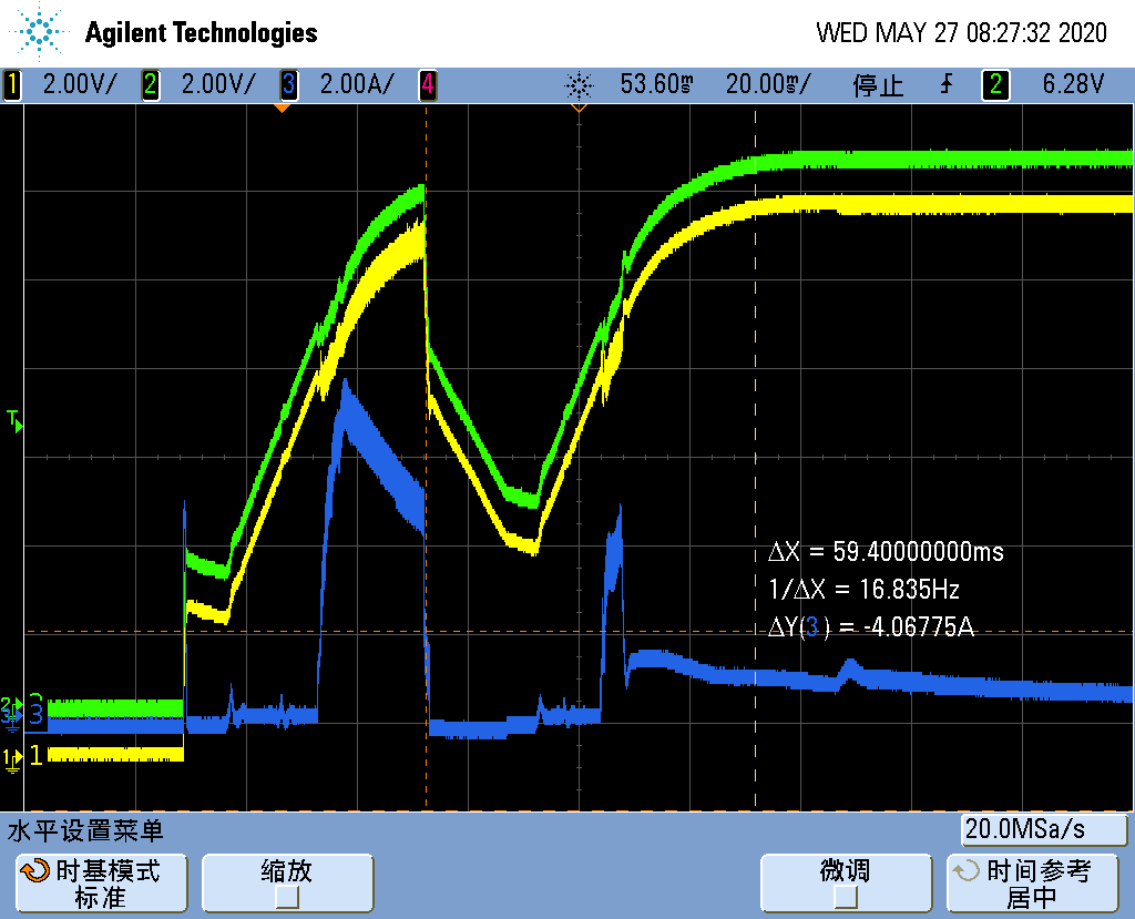

Below is using 100nf//100nf Css capacitor
Below is using 100nf//100nf//100nf Css capacitor
And as the datasheet described, the capacitor of Css should not larger than 27nF, so is it possible to use 100nF//100nF?
