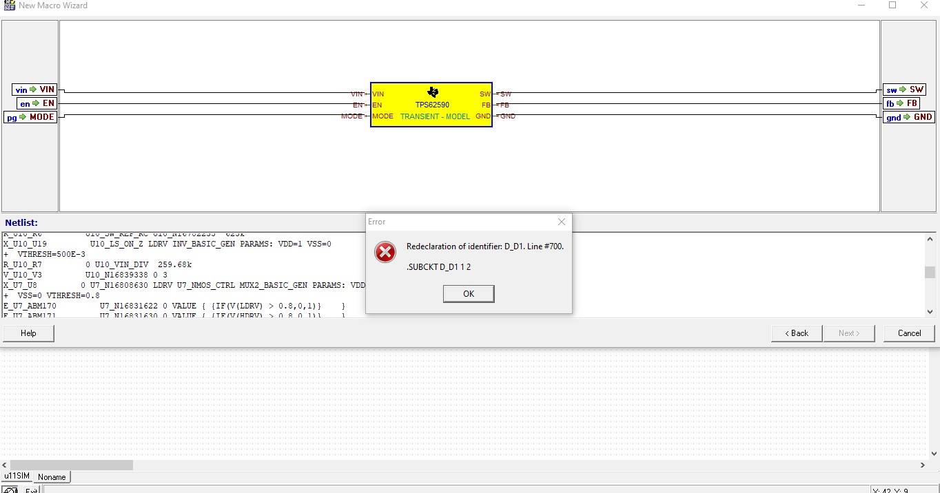

I was wondering if an unencrypted model was available for the TLV62569AP.
Hi Kayleigh,
Please see attached unencrypted model of TLV62569AP.
Excel
There is an error with this file when I try to add it as a macro to TINA-TI. I've attached a screenshot of the error I receive. Also it shows a different part number on the model when I import it to the macro using the file you provided, which is strange. If you could supply a different file with this fixed, or directions to fix the model you provided I would appreciate it.
Hi Kayleigh,
You can use the attached file in importing SPICE model to TINA or the video instruction below.
Excel
Hi Kayleigh,
Apology for the late reply.
I looks like this particular model cannot support TINA. Unfortunately, we still need to request our modeling team generate a TINA model to TLV62569A which will take 4 to 6 weeks minimum. Can the WEBENCH support your simulation?
Excel
Hi Kayleigh,
We are able to modify the model work in TI-TINA. Please see attached file for reference.
Excel
