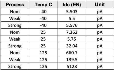

I believe the answer is also in the datasheet on page 3. With Ven=0.9V, and the non-pull down version drawing 0.04uA, then the pull down version Enable pin current will be 6uA typical. This means the pull down resistor is: =0.9V/(0.000006-0.00000004)A or ~151k ohms. The process variation should be considered and could be as high as 20%.
Can you advise if this is the correct understanding?

Can you check the "5128" number in the table. It seems to be way larger than the Nominal and Weak values....
Hi David,
Yes, these are the simulation results. Keep in mind this is a worst-case process corner. Again these are far lower than what is listed as a maximum value in the datasheet.
