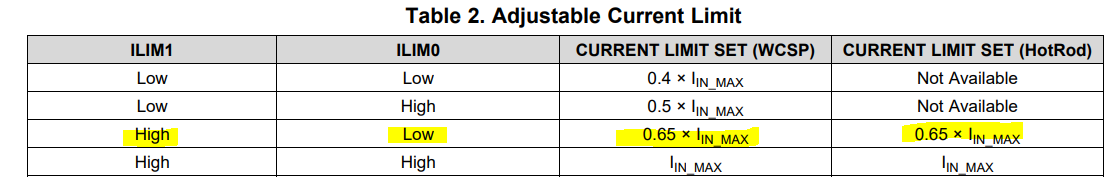

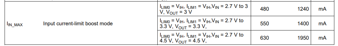

I would like to quick check of TPS63050's input current limit(inrush current limit) setting, as d/s ,
IIN_MAX at the spec Vin=2.7V to 4.5, Vout-4.5V , ILIM0=HI,ILIM1=HI the max input inrush current is 1950mA(max),
in this same case , if I change the ILIM setting as ILIM0=LO,ILIM1=HI , then per spec , the input inrush current will be IIN_MAX(max)*0.65, which is 1950mA*0.65=1267.5mA(max) , is that correct?
