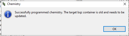

Another funny I had is the following information message when programming the chemID:
However a quick search on the forum reported that it would not jeopardize the learning procedure.
Hope you will be able to make sense of all these clues.
