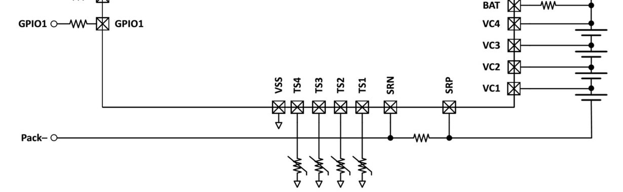

I'm currently using the TI BQ40Z60 board.
While performing the discharging process it is observed that the cell 1 and cell 4 are stressed more and are showing a comparatively lesser voltage as compared
to cell-2 and cell-3. The gg.csv as well as the snapshots of the FET are shown along with the cell-1 ...cell-7356.Learncycle_BQ40Z60_4S1P_3200mAh_registers.gg.csvdischarge based FET's set.csv4 voltages

  • Hello Mihir,
    Could you provide the schematic of system and also the board layout? Can you check to see if the cell voltages remain that separated when the batteries are relaxed? A log file of a battery cycle with a discharge of 30 minutes and relax of 2 hours would let us see this as well.

    We have looked through your log file and .gg.csv file and have a few theories for the issues:
    Interconnect resistance
    • Please provide block diagram of how you hooked up the cells.
    • Measure the interconnect resistance between VC2 to VC3 connect points.
    • Measure the interconnect resistance between VC3 to VC4.
    Cell to cell variation
    • Take apart the individual cells, charge each to full, log with same discharge current, temperature and to terminate voltage and determine if there are discrepancies in Qpass. This will tell us if the resistances vary inside the cells are causing the inconsistent cell voltages.
    Enabling balancing
    • It could be the cells are inherently out of balance. The gg.csv file attached shows an update status of 0x04. This means no field Qmax and no learning cycle has been completed. Balancing won’t be enabled.
    • Go ahead and complete a learning cycle after the first two theories have been ruled out.
    • Once learning is complete, enable balancing to see if the voltage variations are reduced.
    One of these is most likely the issue, see if these help debug your system.
    Sincerely,
    Wyatt Keller

  • Hello Mihir,
    The interconnect resistance would be a part of your board's layout, not from the schematic. The traces/wires must be large enough not to cause much IR drop across them, otherwise it can lead to similar graphs as this.
    There was no mention of doing a Qmax test on the cells in the previous thread, are you certain they are all of equal capabilities?
    Make sure there is minimal noise on the HSRN and HSRP pins as well, you mentioned in the other thread you can reach your desired charge current by changing the threshold, can you try doing this and completing a learning cycle to see how the gauge is operating?

    In your previous posts you mentioned related to interconnect resistance and cell to cell variation.
    I went through the capacity data as you mentioned and obtained that there is a variation of 100mAh between the cell 3 and cell 4
    because of which we might be observing the voltage variation. Similarly, there is also some interconnect resistance we are having nickel
    plated copper busbars for cell connection and I tried using multimeter to obtain the resistance and got the values pretty high
    I've asked for the datasheet to the vendor from whome I've obtained the busbars. Meanwhile a new 4S cells with 2650 mAh discharge capacity each
    have been selected again and are going through charge cycle.
    I will perform the learning cycle again and keep you posted on the same.
    Mihir

    In order to remove all the wiring issues we tried doing spot weld in order to have the least resistance while doing the 4S1P connections.
    I'm currently working on a newly bought BQ40Z60-EVM, I thought my older one might had an issue.
    Currently even when all the cells are at same voltage level when they are 100% charged using a neware recycler, even now when I perform
    the discharging / charging process for my learning cycle there is a gradient in a voltage as I mentioned earlier, i.e. the cell 1 and 4 had a lower voltage
    while dicharging in comparison to cell 2 and 3 voltage and the completely reverse phenomenon is observed during the charging process. The cell now that I'm using are having the same  discharge capacity as I observed the cycling data of the cells also cells are newly bought cells
    Please respond the current issue.
    Mihir

  • Hello Mihir,
    The spread between the cells, when one cell hits the termination voltage other cells are over 500mV higher than that. Somehow there is still interconnect resistance or the cells don't have the same capacity when charged to full it seems.
    Sincerely,
    Wyatt Keller
  • Hello Waytt,
    Sorry, I thought by doing spot welding the interconnected resistance might have reduced and
    actually that was not the case. The voltage drop between battery positive and the VC5 pin was
    50mV while the voltage drop between the battery negative and VC1 was 90 mV(approx) this used
    to cause the error during the charging as well as during the discharging cycles.
    So yes the interconnect resistance is the cause for the fault that I was observing. Similarly the charging and discharging
    learning cycles now are happening and I've observed Q update flag set to 06.
