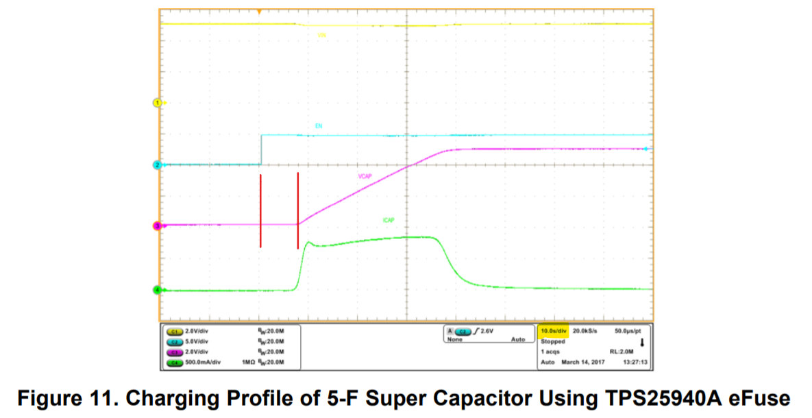

  • Hi Muneeswaran,
    By using dvdt control, you are indirectly limiting the current during startup. Generally, dvdt current is set to a value lower than current limit because most of the applications require higher load current in steady state operation. But in this case, charging the super cap itself is the main operation and I don't think you will require higher load current than 500 mA.
    Below are the advantages of using current limit rather than dvdt control for charging supercap,
    • You can get rid of the high dvdt capacitance. To disable dvdt, you can leave the dvdt pin floating. The device will automatically start in current limit
    • dvdt capacitor adds delay in startup. This is because the voltage on dvdt is reflected on Gate of the internal FET with some gain. The FET doesn't start conduction until its gate voltage goes above its thershold voltage Vt. This delay is not expected if you startup with current limit. For example, you can refer to Figure 11 of the app note http://www.ti.com.cn/cn/lit/an/slva920/slva920.pdf?ts=1591629931797&ref_url=https://www.google.com/
